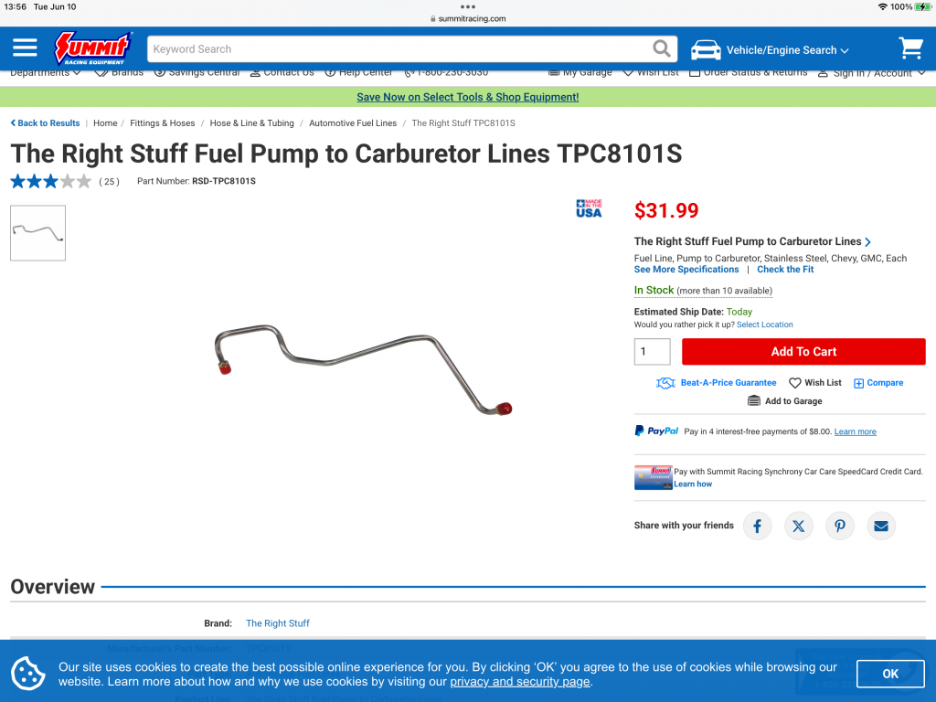

Always just made my own out of the line from the part store or AN fittings and PTFE hose depending on the application.
Furr
May 11, 2025
SC
Kenneth
K5 Blazer
Installed this recently on my 78 Blazer. Perfect fit.
