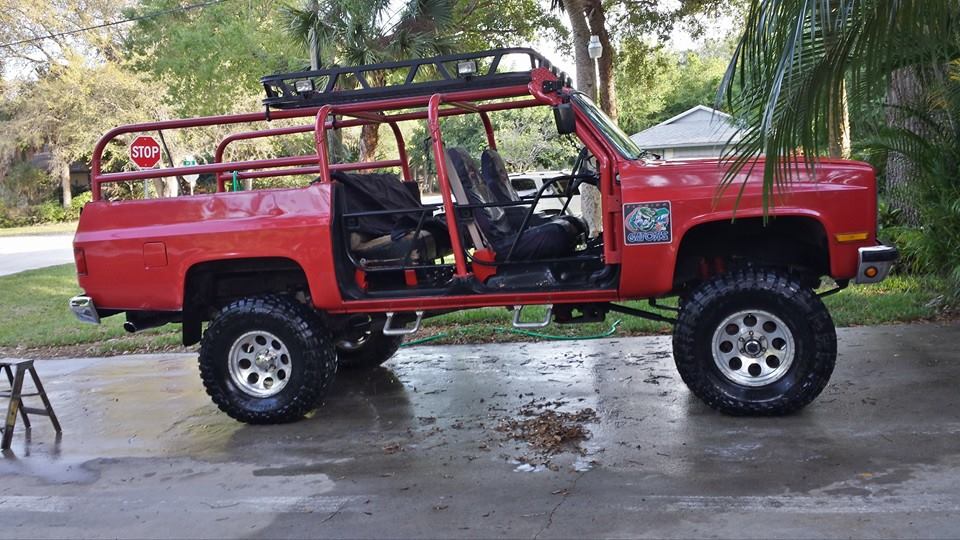

https://www.gmsquarebody.com/attachments/safariburb1-jpg.82529/
You can get creative and still make a cool truck...
This was probably cheaper than a full restore.., if he bent and welded the Tubing himself...
Here's a Blazer...
Something like this would work as well...
If the rear fenders are beyond repair, fiberglass the roof and weld a flat bed on her...
Here's a C10 headache bar...
Exterior roll bars are the way to solve your roof rot... interior roll bars should only be used for driving with a helmet on and 5 point harness, or you'll split the pumpkin open...
However there is something to be said for interior roll bars...
Less body work MORE ENGINE...

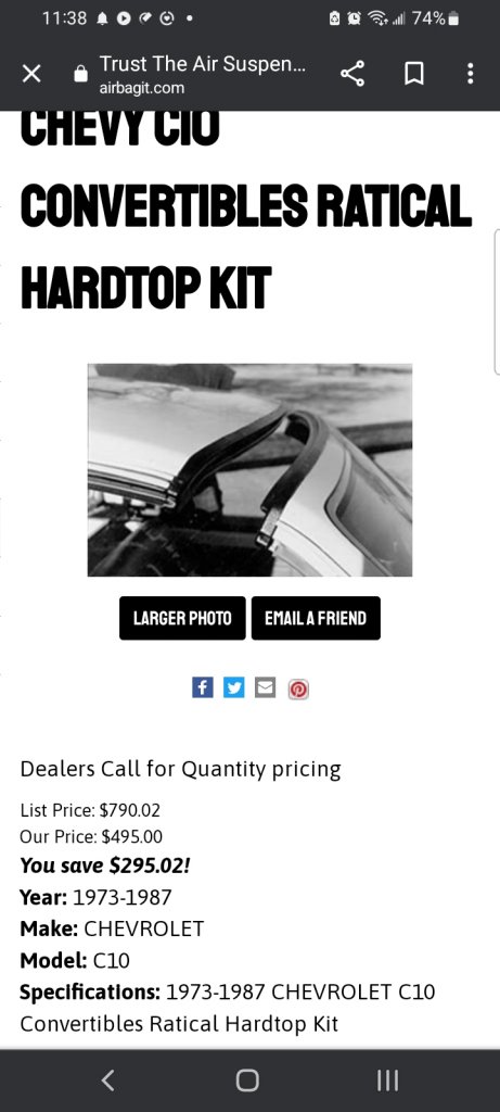

Wow,here they came new with rust,you won't find anything that doesn't need major rust repair here. If rust free cabs are easy to find and cheap,great. Not around here. Now I did find this kind of interesting and cheap,anyway I think so. Hardtop convertible kit for c10 the instruction pdf was to large to attach.
Those are cool! And cheap! The pic sucks though. Is it the top and b pillar/back window as well?
I mean, the OP likely has cowl and windshield frame damage as well. But would be neat to have a targa top squarebody.
And yeah different story in different locales. Which I based my recommendations considering.

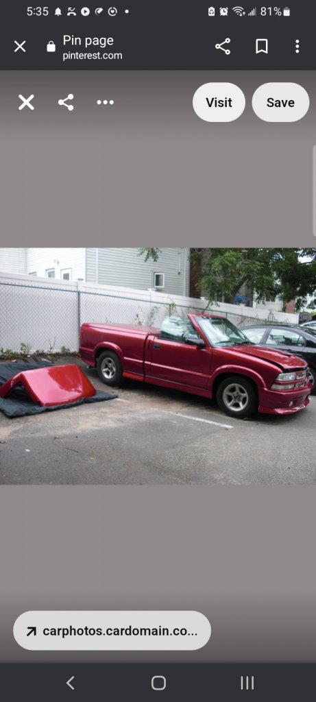

I can't find anymore information, the end result I think is the pic I'll put at the bottom its an s10 but best pic I could find. After looking and reading it looks like abs plastic caps to cover where you cut the roof and hook and latch type fasteners to hold the top back on.
