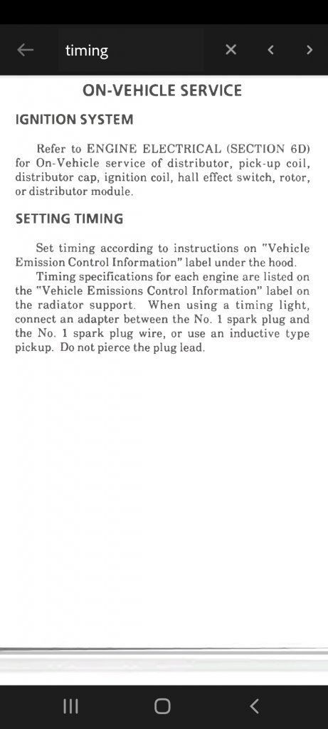

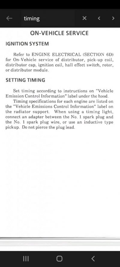

Disconnect battery ,Unplug my est then I thought I had to turn the crankshaft by hand to get the rotor pointing roughly in the 7 o’clock position or 1/3 between the #1 firing order and #8 firing order on the compression stroke . Put back on distributor cap and wires then Plug in est , reconnect battery. Start the truck Then adjust distributor cap by feel or intuition. What part of my method is wrong? Thank you everyone!
here is what the manual says is correct -
Okay can you show us your VECI label because I have a feeliung your VECI label says something like:
(incase it was not clear by the manual, it says to follow your VECI label. which if your VECI label matches this one, you hopefully understand what that means then?)
NOTE IDLE AIR SPEED SCREW IS PRESENT AND SEALED AT FACTORY, PROVISIONS FOR ADJUSTMENT DURING TUNE UP IS NOT PROVIDED. DO NOT ATTEMPT ADJUSTMENT
IDLE SPEEDS ARE AUTOMATICALLY CONTROLLED. DO NOT ATEMPT ADJUSTMENTS
See boring blah blah for more.
TIMING (*BTDC) 0° (M in N/AT in P or N)
the actual timing procedure can be read by you and here is a lengthened canadian version of it

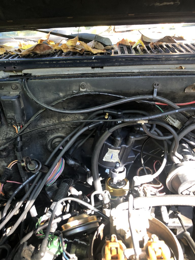

I pulled the distrib cap off and it looks like the rotor is pointing directly at the #1 on the distributor cap. The rotor is also pointing slightly toward the passenger side( should it be pointing towards driver side?)
Ok, I then disconnected the est wire (black with tan stripe) , then I put a 2 degree retard on the cap , (no timing light used) then started the truck, seemed to idle good , put it in gear sounded ok , I shut truck off , reconnected est wire, disconnected battery for 8 minutes , reconnected battery, started truck n test drove it, seemed to have better power , only slight bogging when put in gear with brake depressed it didn’t die on me but rpms do dip (no tach)
I am pretty positive that I can find the perfect marriage setting between the idle screw setting and the dist cap setting just by making small estimated adjustments on either one
I do feel I might be wrong with the rotor pointing slightly towards passenger side?
Thank you everyone

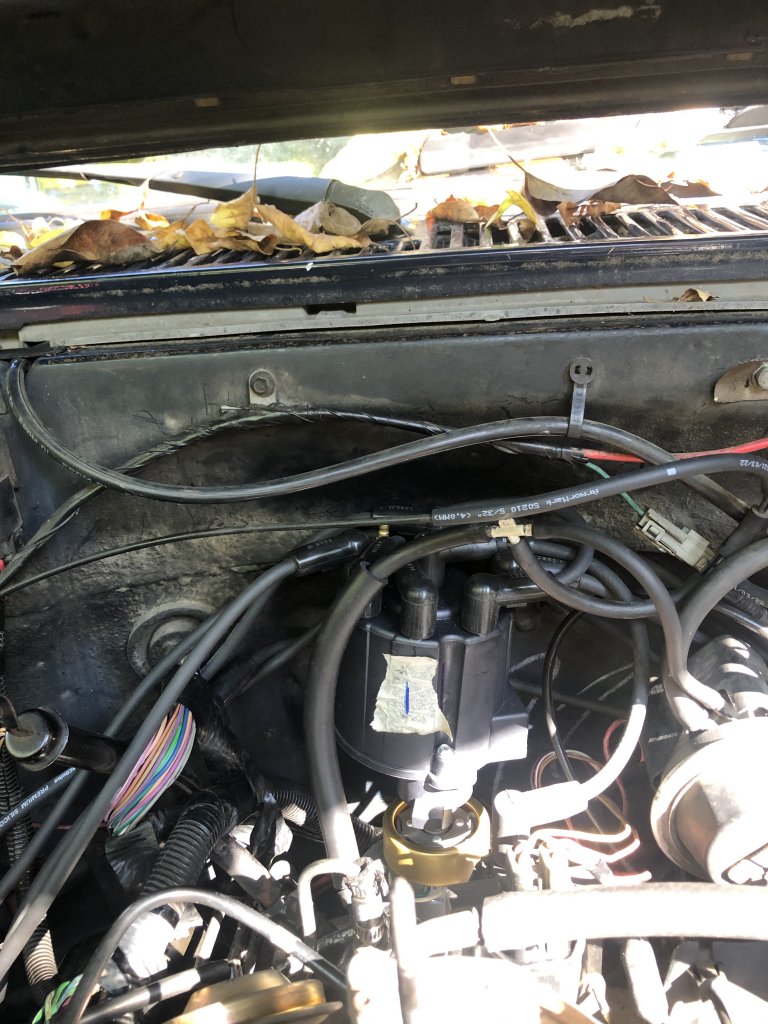

Slightly pointed at passenger

You should not be adjusting the idle stop screw to raise idle. The is an IAC adjustment procedure and you are supposed to disconnect the IAC valve and then manually adjust that screw to a achieve a certain engine idle RPM. The TBI should then be controlling the IAC valve to get the correct idle at all times.
I would guess you have either clogged injectors, a massive vacuum leak, or both. I can see what appears to be a massive vacuum leak in the picture you posted. If that hose in such poor condition, I would bet there are more as well.
