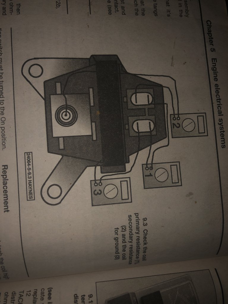

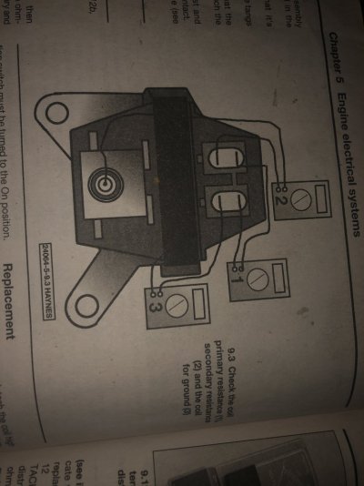

Sorry better pic I’m assuming I need to ground the yellow wire to the block or body?

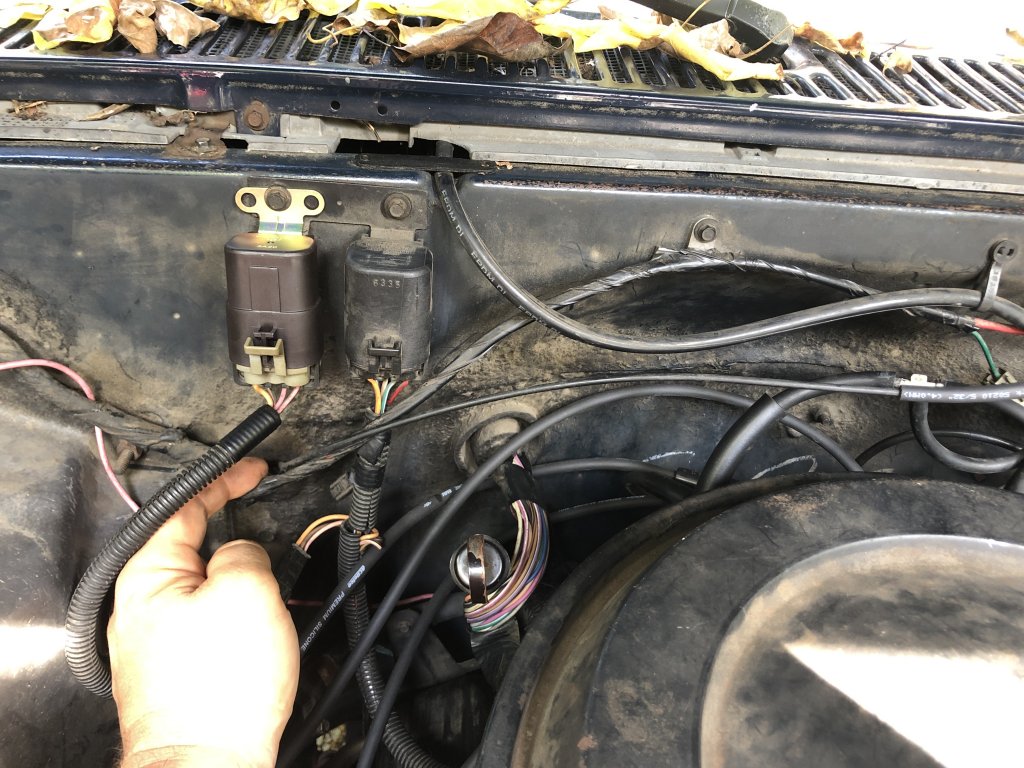

with my index finger I’m pointing to that skinny hose that was broke . I then added a sleeve over it and connected it to the t fitting
