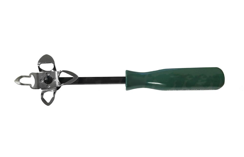

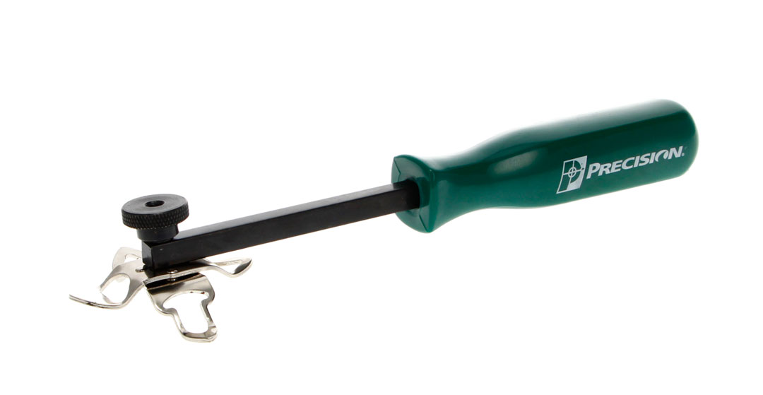

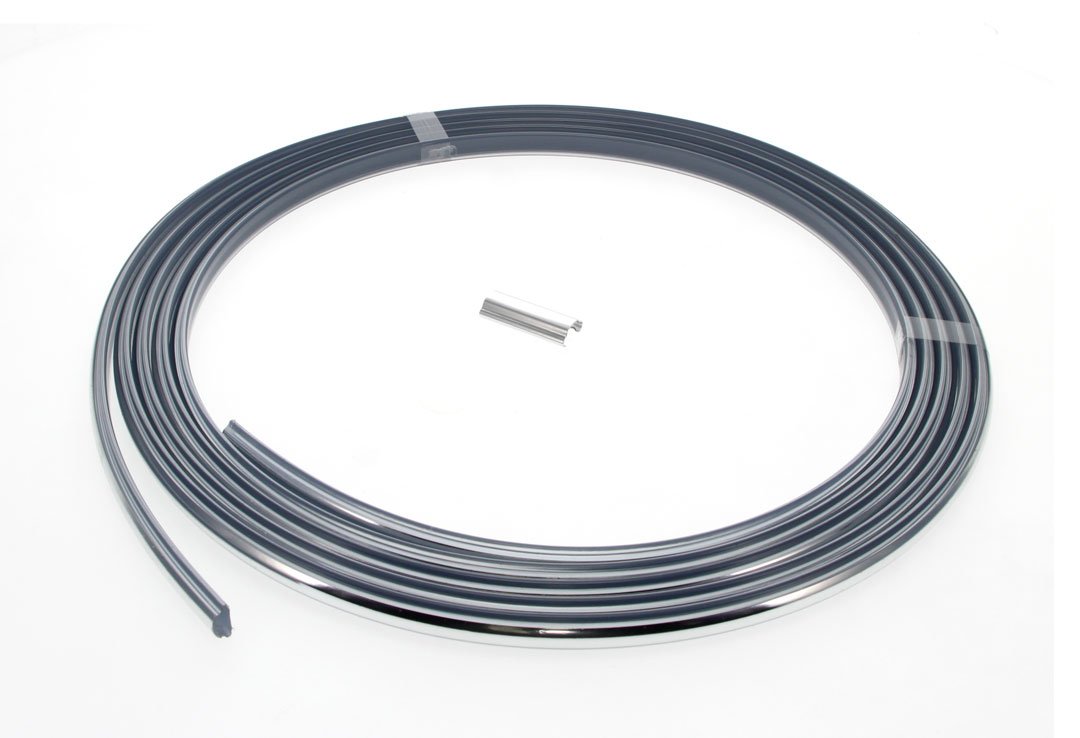

Yep, need this:
And this:

Short answer, yes. Longer answer, if the gasket is old and hardened it may be considerably more difficult. however I don’t think it could be more difficult than actually reinstalling the windshield. That’s a bitch!
And don’t even attempt without a lock strip install tool. And smooth the edge on the tool that gouges the chrome on the strip when you slip a little. You’ll know which edge the first time you ding the new chrome colored plastic.
