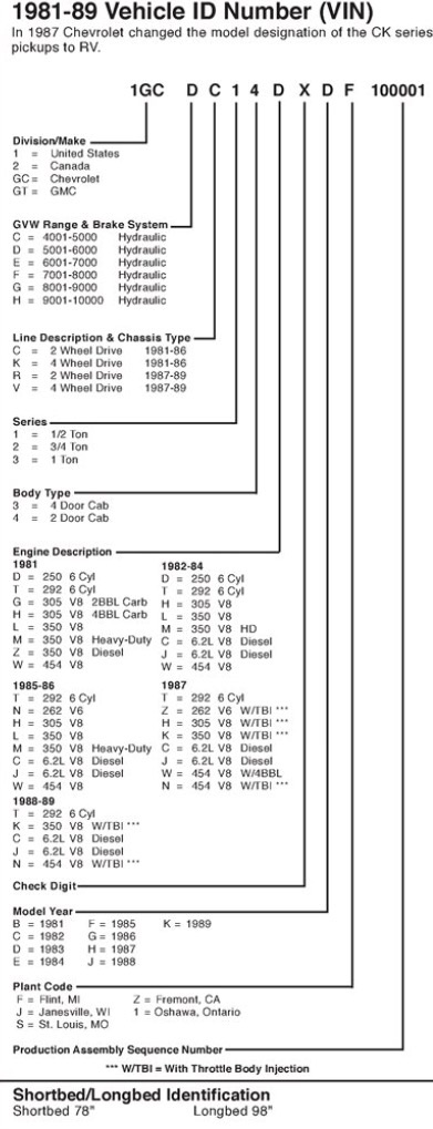

This is the VIN decoder for both of y'all's trucks. I think I understood y'all right.
