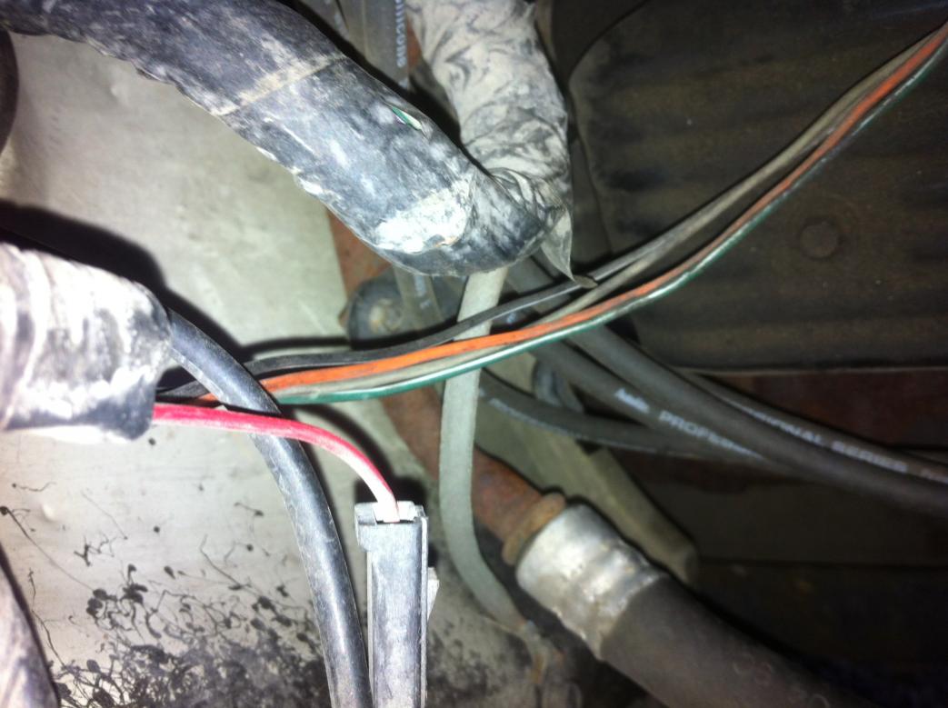

sorry to be butting in here, just gonna see if anyone has any input on this.. I think the water pump is oem... I think the water pump is cracked, it seems to be leaking from the side of the lower hose tube, does that sound right? do these things just wear out and start to drip? its pretty rusty
not sure if you can see the drip or not, its kinda a bad pic, its right above the hose (shot from under the truck)
There is a weep hole under the bottom of the pump if the inner seal goes bad. Check your hose clamps, snug them
up.

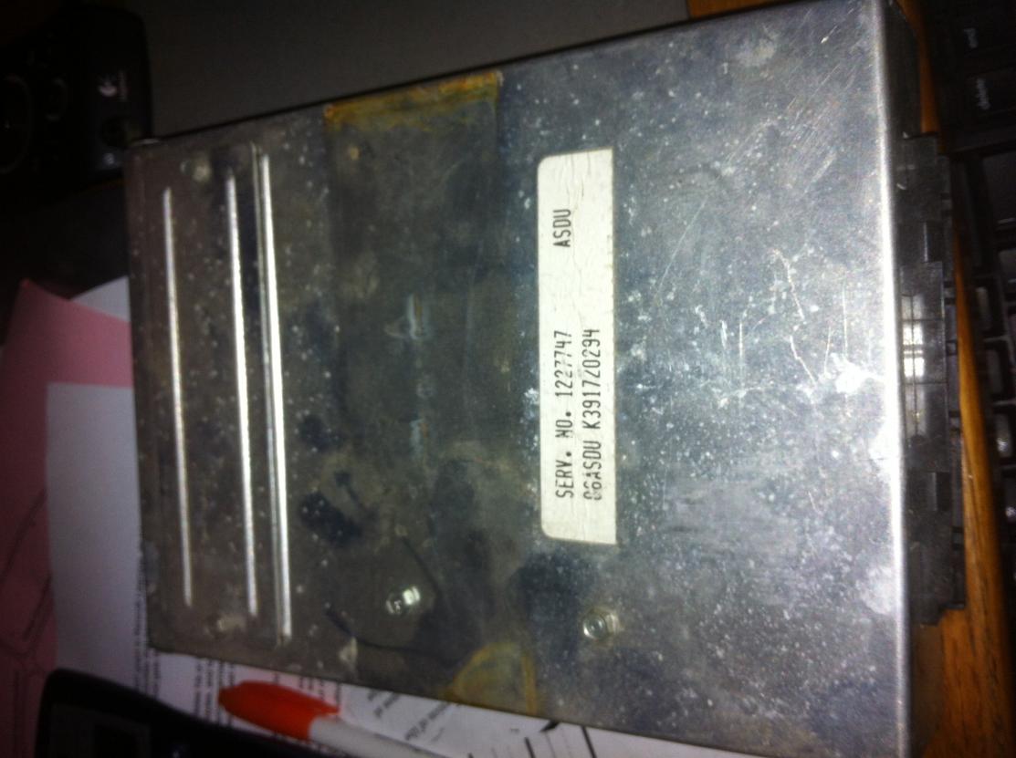

I have a 7747 out of a 89 k5 thats been in my garage cabinet for 6 years now.. truck ran when i took it apart it's yours if you need it
up.
Sent from my iPod Touch 4th Gen using Tapatalk
I changed the hose and clamps, still drips when i fill it up... I think this is an early warning sign, it did seem to run a little warm before the drive shaft crapped out last year... im just gonna change it, what are they, about $40 right?
If you were directing that to 89Suburban, yes, he does need it. I sent him a message, he should chime in pretty soon.
Sunova bitch. Is that good Jim? What ya want for it? :)
Cool. 89 for an 89, should be the same one. Even if one was 305 and 1 was 350 they should still be the same. PROM chips might be programmed a little different but should be the same ECM !!! :waytogo:
Yap, once in a while something good happens for Paw Paw. And past year it's been members here hookin me up with parts. :)
