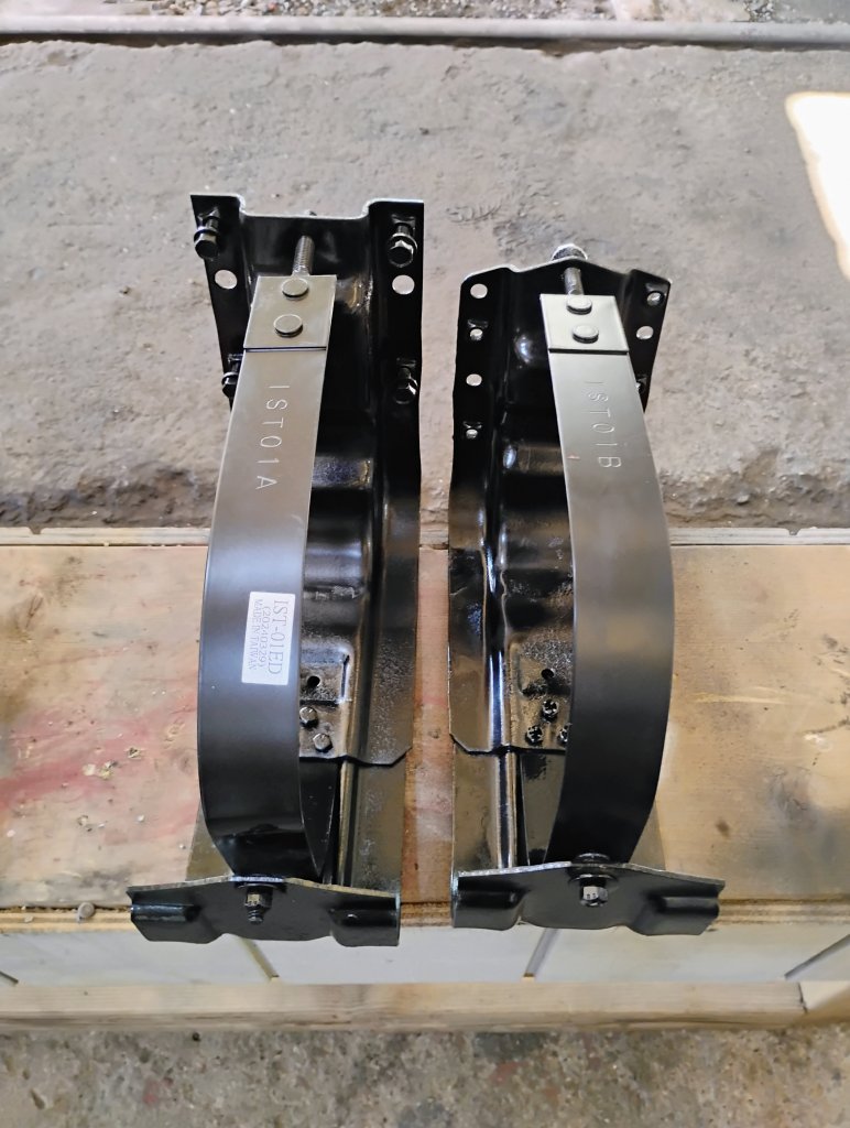

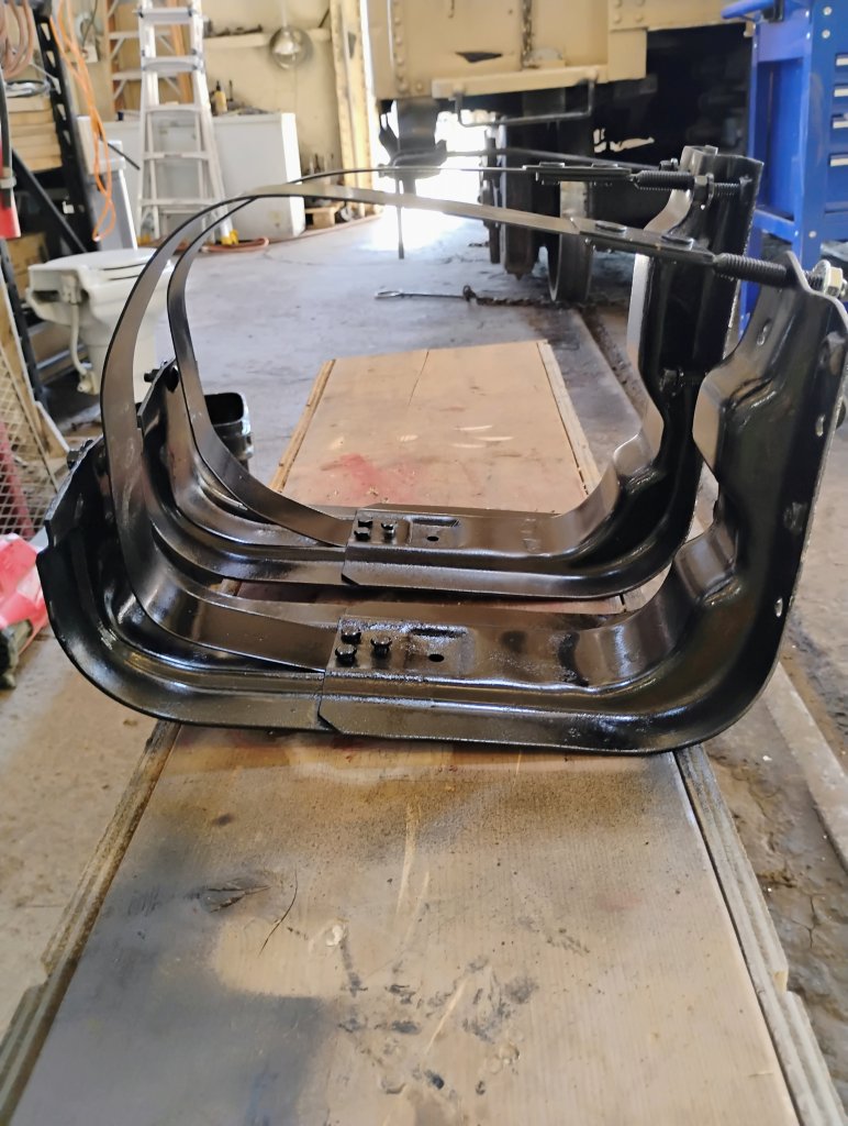

I can do them by myself,no jack if they are empty. If you are using new tanks new straps new brackets leave the straps just barely snug,push the forward end of the tank up start 1 bracket bolt use it as a pivot,push the other end up start a bolt get all bracket bolts in place then tighten the straps

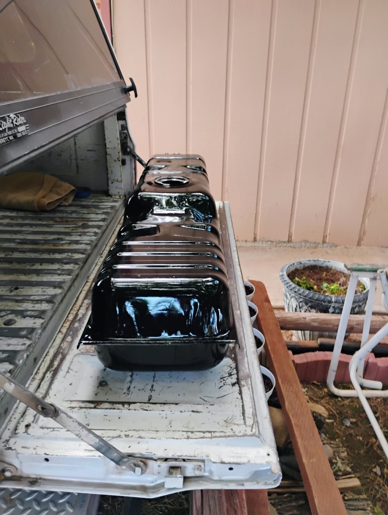

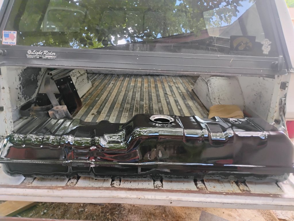

I just installed a new tank, drivers' side, on mine. The new gas lines are a lot thinner than the original and looked like it may rub on the frame so I took a short chunk of garden hose and slipped over the new line, then connected the new gas line as suggested by Ricko. I have a motorcycle jack so I used that and found it VERY helpful. Welcome aboard
