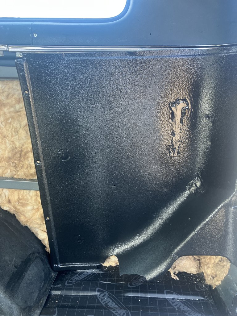

spent the day working on damaged panels from previous owners. It was a bugger, but I used fiberglass and matt to fix the panel, and it worked good. Tomorrow we will start paneling the sides as all the work is completed now so we can do this. I will raptor line the other side tomorrow as everything will be cured.

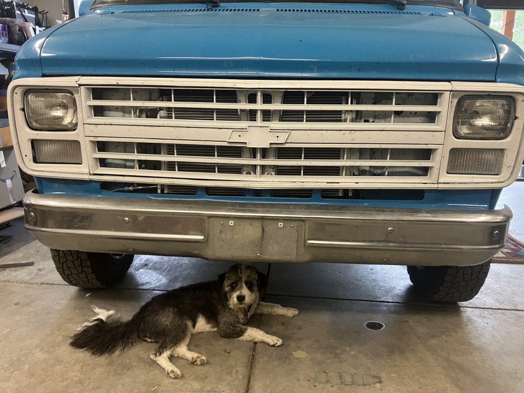

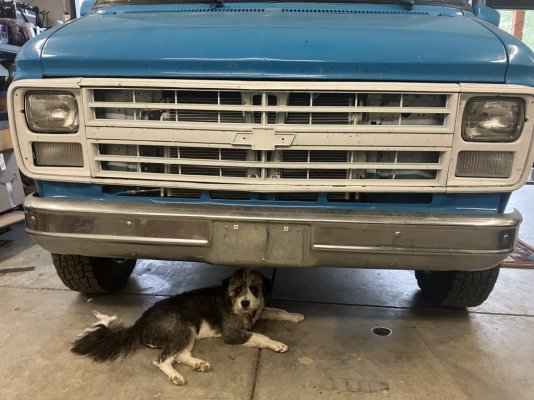

We are looking for a grill for this 1991 GMC G20 Rally extended van. If anyone has one , and wants to sell it, LMK. The one in the pix is not original, not even sure what an original looks like. I think the trucks are 3/4 inches wider? I think this is the correct look.
Truck and van grilles are essentially the same. I've installed van grilles in trucks more than a few times. The big difference is the upper screw locations. When installing a van grille in a truck, the upper screw locations need drilled. Not a big deal at all. It used to be far easier to find van grilles in nice shape than pickup grilles.
Now with that said, I've never done the opposite swap. Not that I can remember, anyway. I don't remember if truck grilles have enough meat where the van mounting screws need to go.

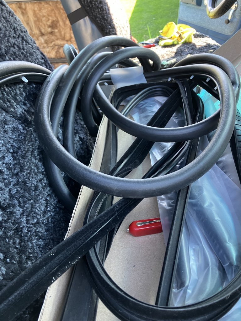

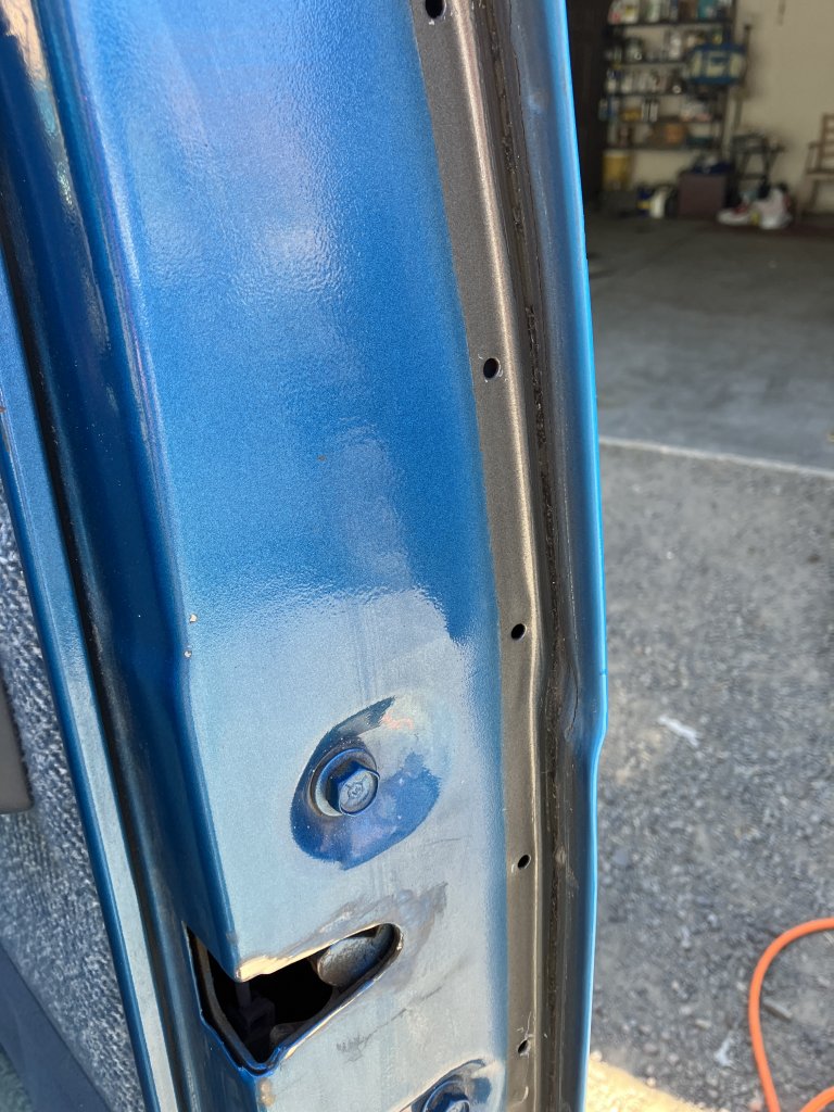

Jan and I got some more done. Jan is cleaning the doors, and getting ready to install the last of the weather stripping on the driver and passenger doors. The soft seal products are very high quality. I have used them several other times, and every time the fit is good. We use 3M weatherstrip glue, excellent.

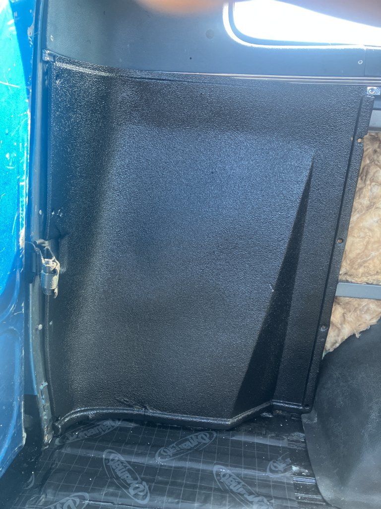

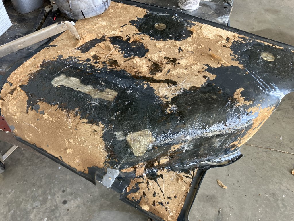

We uninstalled all the previous floor stuff and Jan cleaned, I rustproofed, she painted, (Magnet satin epoxy). the Next day we laid down the heat and sound deadener, Dynamat Extreme, and rolled it on. My wrists are sore! Next we are going to install hardboard wood on the sides using the old panels as templates. Here are the poor panels I had to fix from ham ****** PO. They are sturdy with the fiberglass I did the other day, and I Raptor lined them. The one on the right I should have used body putty and etc., but is will be hidden by the bed and frame.
