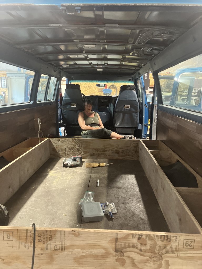

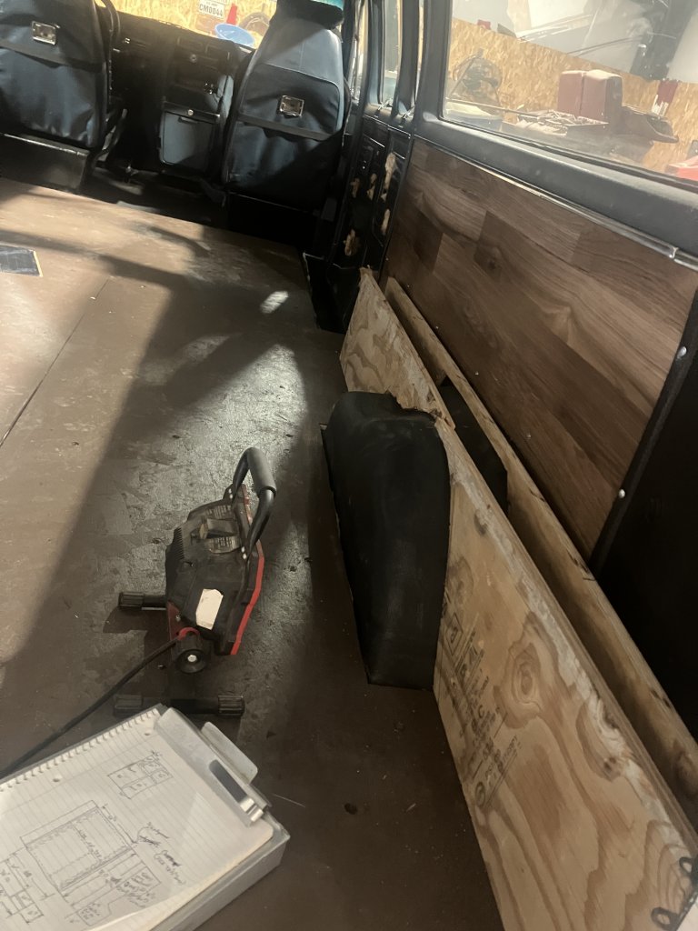

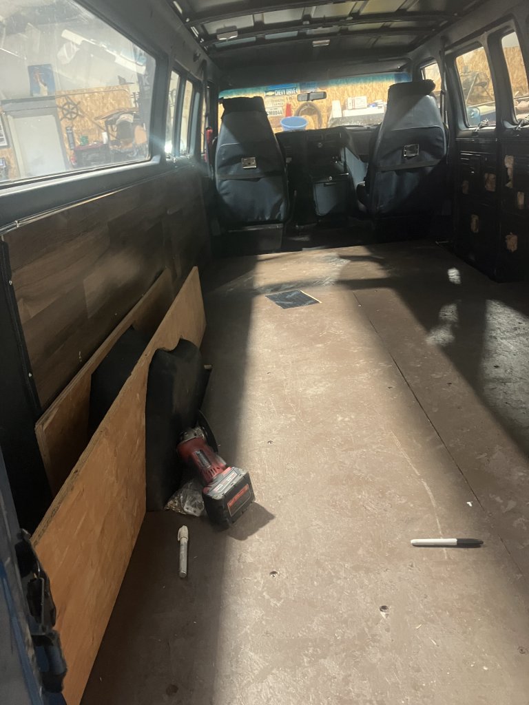

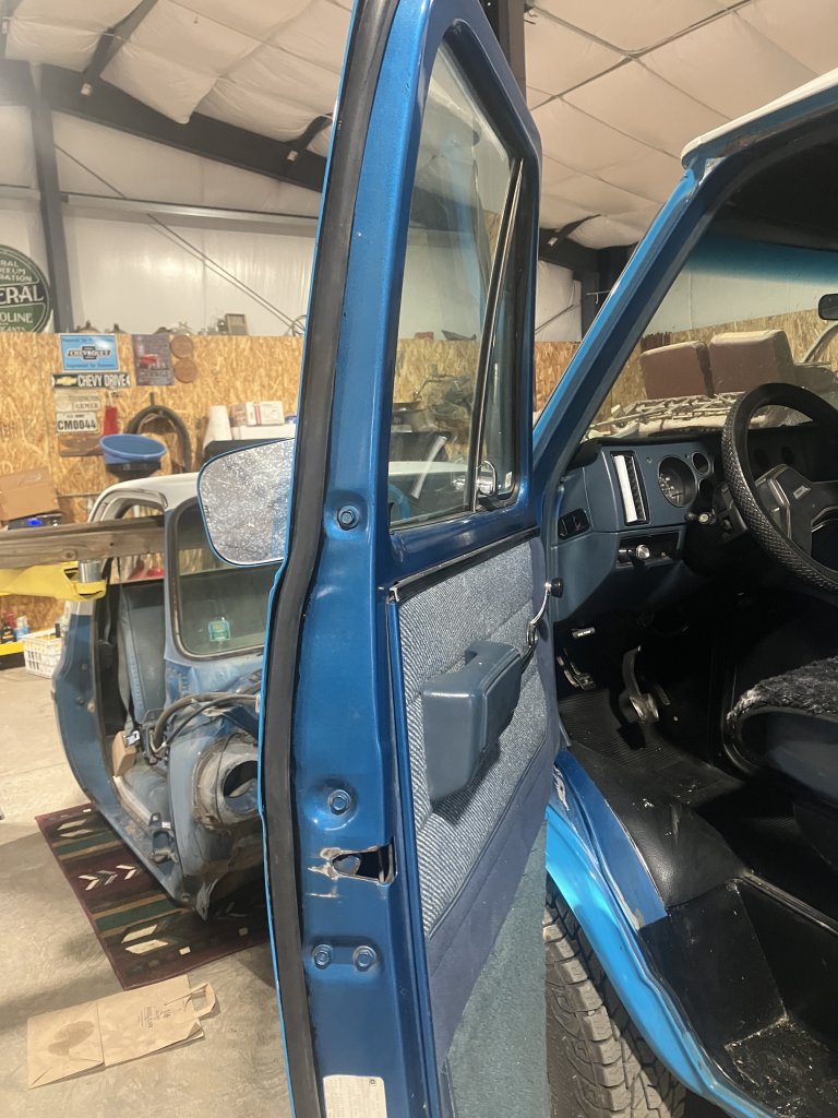

Got all the doors done, yep, all 6 of em. Started the bed frame today, have it done tomorrow. Also got the floor down, and Jan painted it. Jan and I put up the paneling, ugh. Jan wanted to insulate the panels, no problem, but she is stubborn. So anyway she put 1/2 inch Dynamat extreme over the whole panel, told her it wouldn't work as I screwed the panels into sheet metal body braces. You can see it in the first picture, the passenger side of the truck. So now we get to take it off and cutout wherever there are braces, or interference. Then the wall will lay flat, and the brace will fit flush with it, all good. God is gracious, we're still married. I hate doing things twice, but there is more piece if I let Jan do it her way. We have had to fix so many things twice, now she just says, "You can do anything you want." Whew.

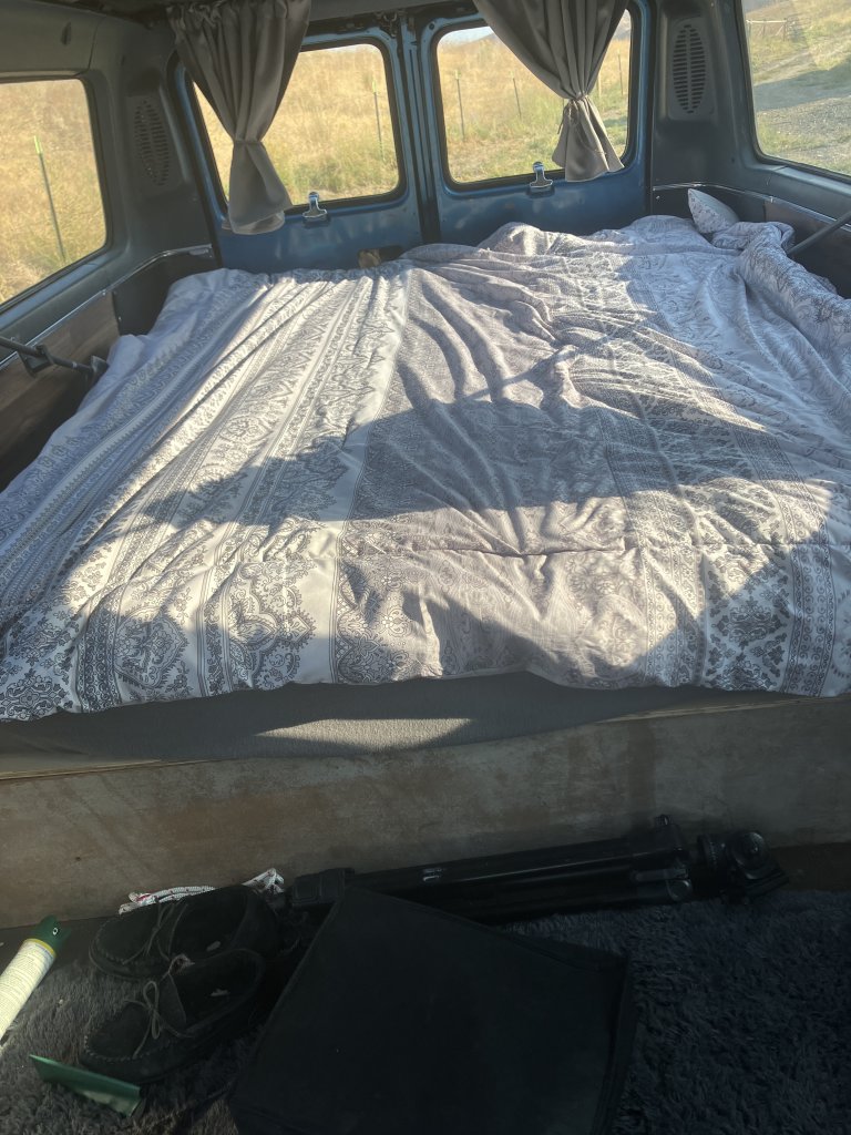

Jan and I are still married, and now we have a bed platform in the van, and actually it is pretty nice. A few pics from Bonneville, yes it was great. Toyota went about 100 mph, Burb was driven from Tennessee pulling a camaro and the guy said nothing fell off, second year I have seen that burb. Our van ran like a top, needs more power, and only 8 mpg, uugh.

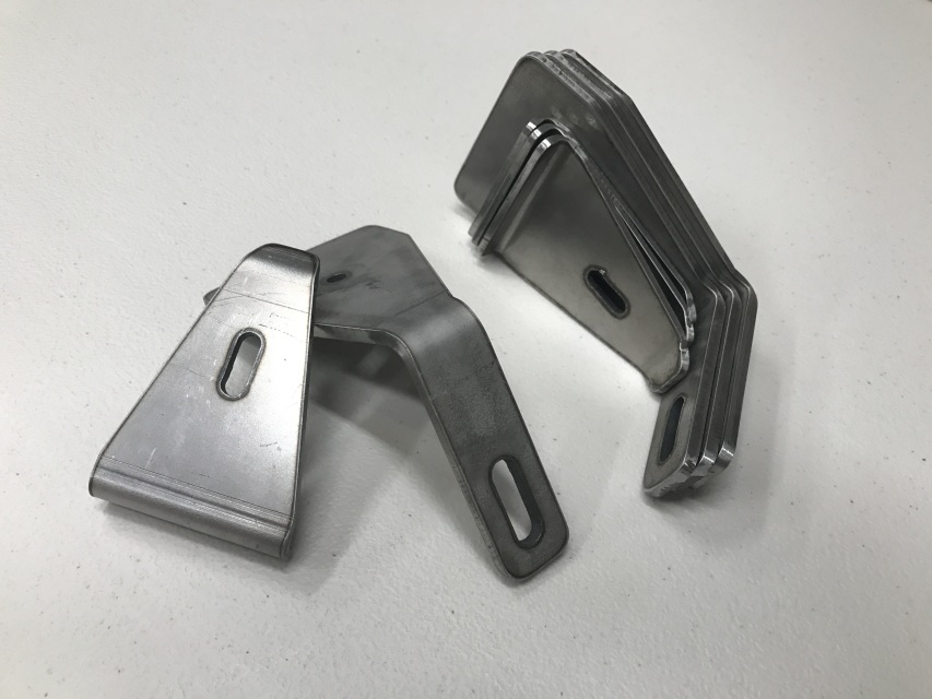

Jan and I are still busy on the van, though haven't posted in a while. I bought a new remanufactured steering gear as the old one leaked and was loose. That should take 90% of the slop out. Also bought drip rail brackets, from K Suspension out of Idaho. These are just what I was looking for. Here is a link:
Son in law has his own electrical business, and I will source my uni-strut through him as he gets it wholesale. Merry christmas Everyone!
