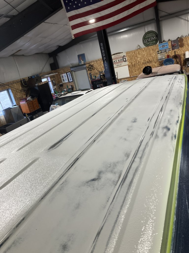

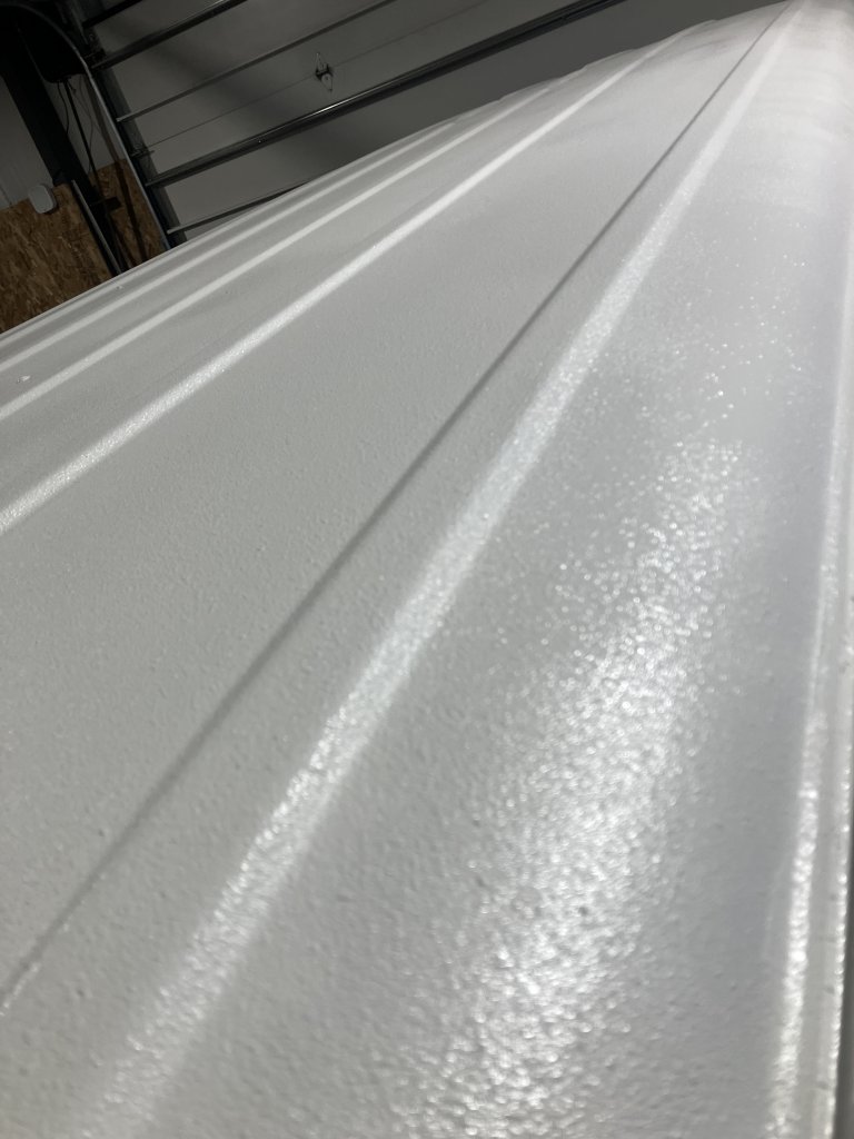

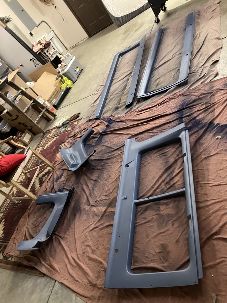

Before and after pics of jans Van roof, Jan did a lot of the sanding herself and then I sprayed the raptor liner on there. She helped with the masking too. What a girl.

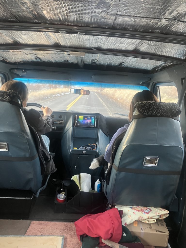

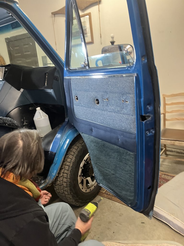

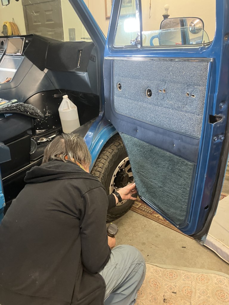

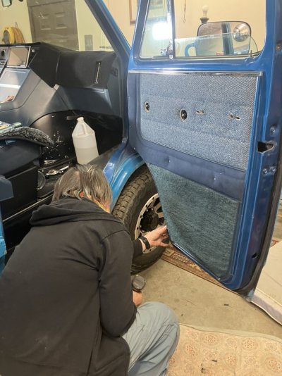

So Jan (evil step mother), cohoused my eldest daughter Leah, (evil step daughter), to help her install new window channel and wipers on the front doors. It took them ,me, about three hours, and was surprisingly straight forward. In the third picture, you can see her video on her new radio and she has a back up camera. That’s pretty impressive. We were also able to purchase three 405 W solar panels so now I gotta get busy but we’ve both been down with the flu for about a week so maybe next week

I'll find out I think Jan still has a can.
I'd find that out. Also find out if adhesion promoter and all that good stuff was used first. Most have found painting these interior plastic parts don't look good for long. The paint ends up getting rubbed or worn off pretty quick. Now if you use the correct methods as far as prep, and then use the proper pre treat products, they tend to look good for a very long time. Technique and Product are important for these type of parts.

It should have turned out just fine then. :waytogo:
It is really stuck on their good. We moved the bed in and had plywood up against it jerking it around. It didn’t even make a mark works great.

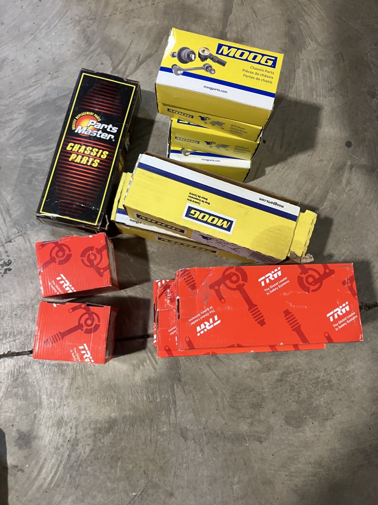

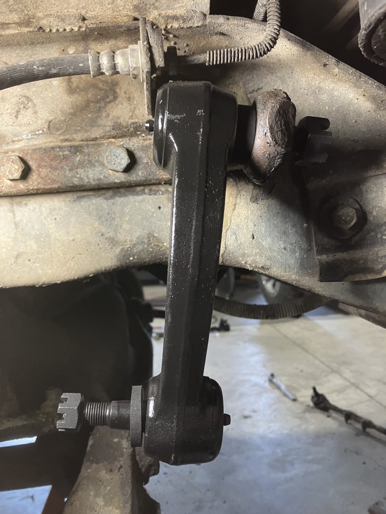

Poor K20 languishes while I work on Jan’s van. We have driven it to Idaho a few times and the steering is horrible. Replaced the steering box because it was leaking. It helped a little so now I replaced all the suspension on the front end and it goes down the road excellent. I just did the tow in with the string method, it worked excellent really feels great. You can let your hands off the steering wheel that goes straight down the road so amen and hallelujah.
