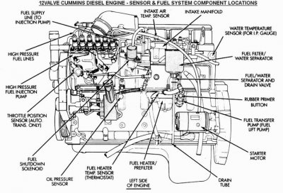

Alright so im with you on everything except the where fuel filter should be. Are you saying it is on the engine block or on the truck?

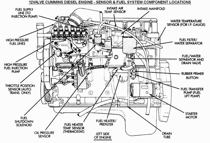

It should be to the side of the intake manifold towards the back on the driver side. Here, let me show you a picture.
ok so the water separator doubles as the filter then?

No, the water separator is at the bottom of the housing, and there's a little lever there to drain the fuel out of the filter housing whenever the WIF light comes on in the little information center in the Dodge truck. That's all the water separator is, but the filter is a separate piece in the same place. It screws into the top of the housing and the water separator is at the base.
