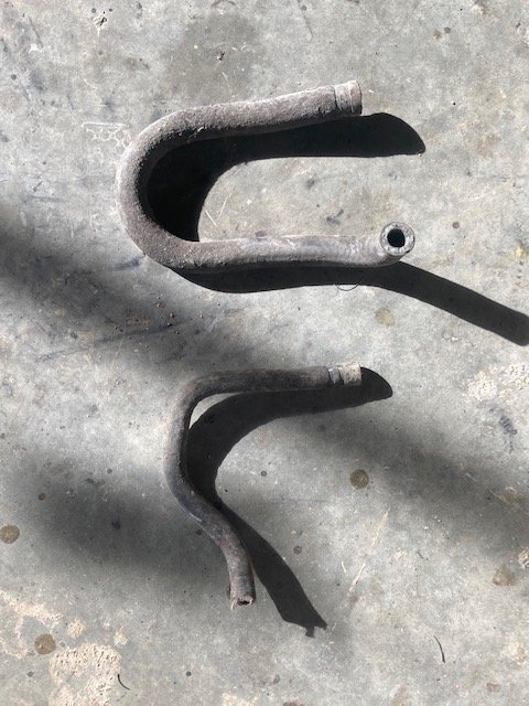

Looking at replacing fuel hoses on my 84 K2500. Does anybody here have an outlet or source for thee premolded fuel hose? Thanks all.

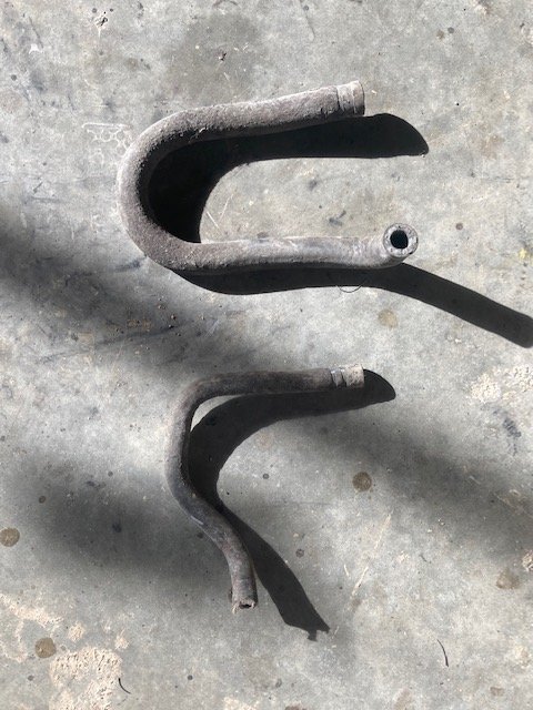

I had an issue on my K30. I found a similar shaped hose from a Corvette that I had to splice and make work. I cut the hose in the middle of the "S" section (photo #2) and added about an inch of hard line to the middle. It needed to be a hair longer and a slightly different twist. Sorry I don't have a photo of the completed hose.
Fuel line @ pump - 1970-81 Corvette Formed “S” Hose
GM 3994298
or
Eckler’s 6271610
