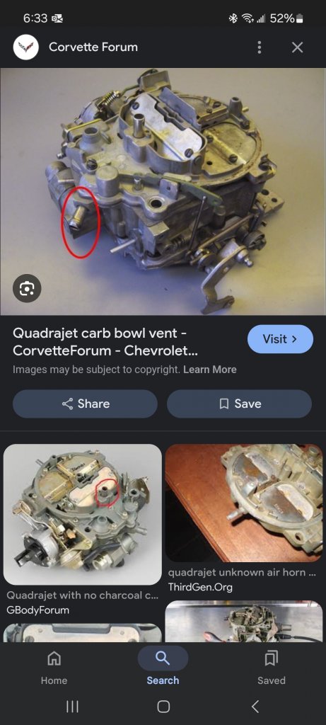

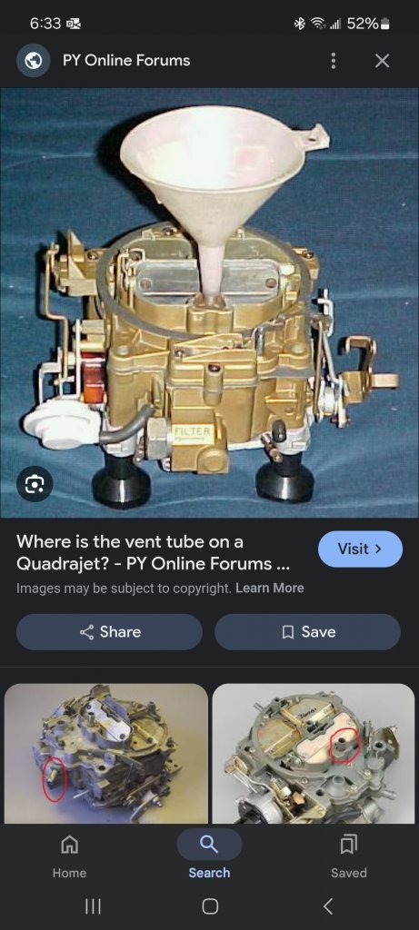

If it's s qjet with a vent hose to the charcoal cannister.,I pull the vent hose off at the carb,and fill the carb through the air horn vent using a mustard bottle or dish soap bottle full of fuel,until fuel dribbles out the vent hose barb. Never measured it,I will next time. Fill where the funnel is until fuel starts to dribble out the red circle.
