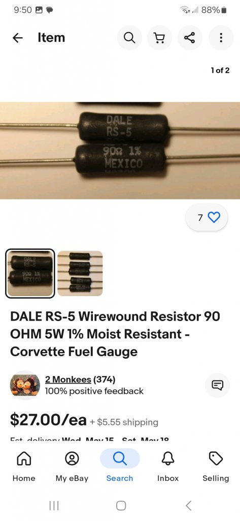

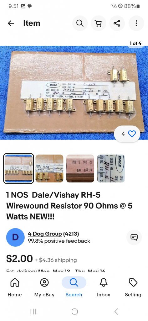

I posted in other thread too. Found these. According to spec they will work. But there physically different. Idk I'm not an electronic guy lol.
