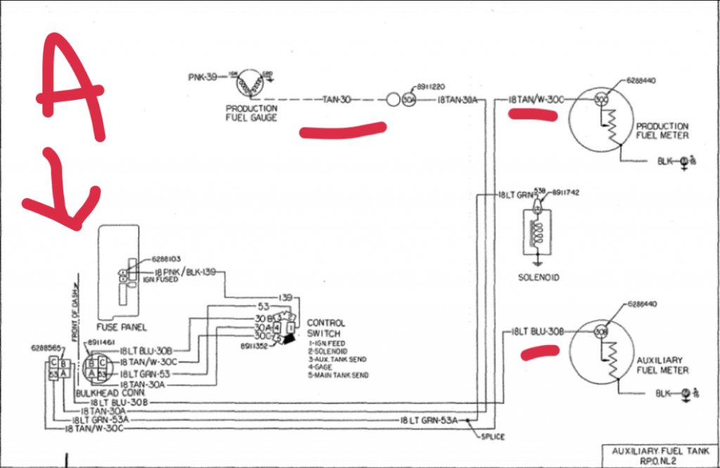

forgive me but i’m new to a lot of this stuff. could you walk me through how i would jump the terminals on the switch? writing drives me crazy
SirRobyn0
Dec 6, 2019
6,731
11,278
Rob
Ok, so you'll take the gauge wire that goes from the switch to the fuel gauge and jump it with one of the sending unit wires, and try it for both tanks noting if either or both of them seem to read accurately that way. That would be done using the wires on the connector for the tank selector switch on the dash. IDK which wires. You'll need to know the color of those wires which will be in the diagram link I posted. I'm sorry but I don't have the time to pick though the diagram to see what wire does what and write the colors down for out for you. Other than being tedious to look at those diagrams I'll bet you can find that info ok.
Someone that knows off hand the wiring color might come in as say too.
75k20
Feb 13, 2022
61
Commie-fornia
i believe i have it figured out. i’ll try to attach the photo. if i have it correct i take the “18TAN-30A” wire and wire it to “18TAN-30C” and see if the guage changes. and then also attach 30A to 18LT BLU-30B” and see what the guage reads?
Yes, but to be clear you want to swap circuit 30C & 30B not attach the two to 30A at the same time.

so i pulled the switch out of the harness and tested the wiring harness by jumping it. While it was unplugged the guage went to full im guessing because the circuit was open. when i tested them it seemed like it would show the correct guage reading only sometimes and other times it would get pegged to zero. do you think the switch is what needs to be replaced?
