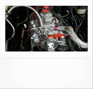

I'm gonna try and do some searching locally. I'd imagine shipping would be killer on all that stuff! Lol I saw an add on Craigslist a little ways away from me had a 350 with a march pulley system on it, the guy wanted 800 for the whole motor, everything but headers, or 450 for the accessory drives etc, everything meant carb to oil pan all together, I don't need the motor, but then again for 350 dollars, if the motor was in decent shape, might be worth it. Pic isn't the best, supposed to get some more sent to me today.
