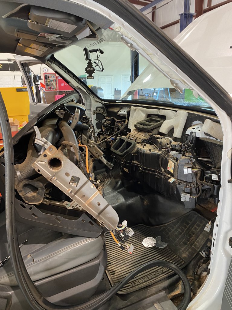

Ford super duty.. what’s super about it ?
Work truck with no cabin air filter , pretty lame for the price of these trucks. The fix for no air flow from the vents , pull the whole dash and the HVAC box . Clean evaporator coil or replace. Replace my moto.

Evaporator cores and heater cores are a pain to get to on all modern vehicles. Having a cabin filter just delays the inevitable, especially if the truck is constantly idling and being exposed to harsh conditions.

GM, Ford and Dodge all break mode/blend doors. Some require complete replacement of the case, very expensive. Of the, 3 Dodge has the easiest dash removal, but it still isn't easy.
