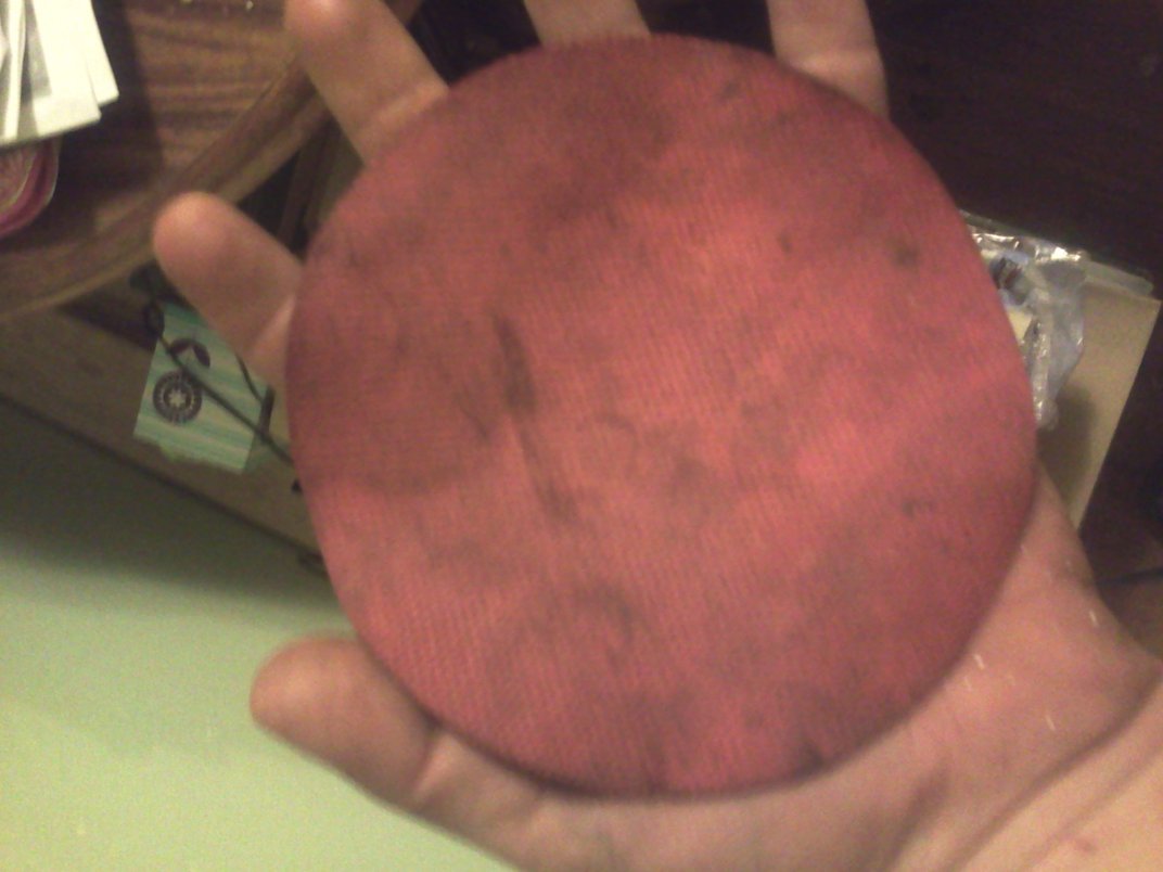

I may get laughed at for this lol.
Its a rubber pad to help older people get grip to opean jars turns out its great for oil filters too.

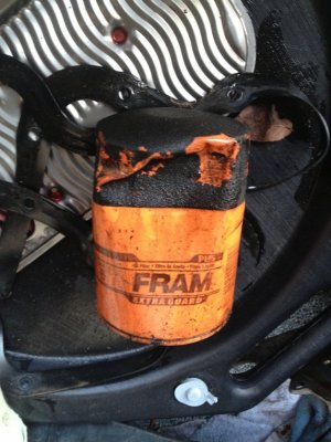

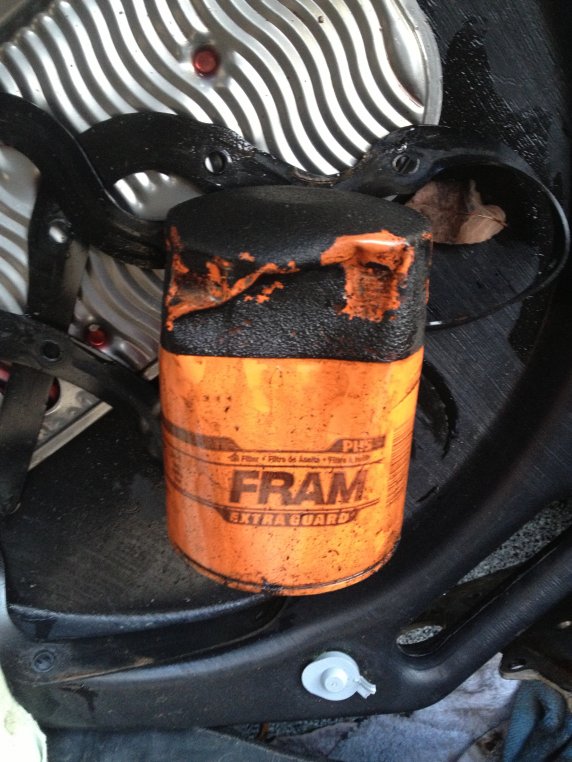

I recently had my first experience of stuck oil filter. Tried my oil filter end cap that you hook a ratchet to and that broke. Went to get some of those rubber wrenches where you pull and they tighter, still wouldnt budge. I realized at that point I had spend almost two hours trying to get the damn filter off and I went to O'reillys and got me a pair of these:
http://www.oreillyauto.com/site/c/d...-1_3816&keyword=oil+wrench&pt=N0066&ppt=C0164
Filter was off in less than a minute.
