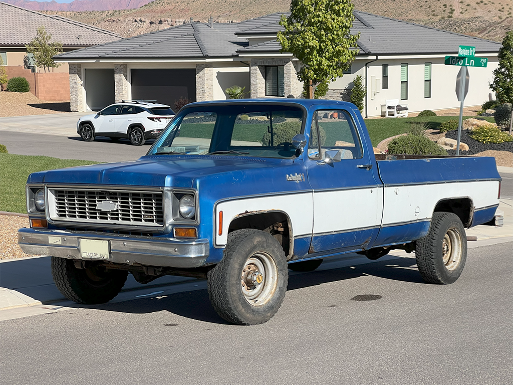

I have a thread i started in the Under Construction forum. But I'll add a quick update here as I first reached out in this thread. I changed the oil and filter, air filter, pulled the plugs and squirted in some Marvel Mystery oil, installed new plugs, topped off the radiator, checked the brake and power steering fluid, and added 5 gals of fresh gas. The tank didn't appear to have much gas left in it, so I thought I'd give it go before dropping the tank. Took a few attempts, but the old 350 fired up. It belched a lot of blue/black smoke for a few minutes then settled down. I kept an eye on the oil pressure, and all seemed good. After a bit, I drove it out the garage and around the subdivision. So cool to be behind the wheel of that old truck. Lots of old memories. I celebrated by giving it a bath!
Now the hard work!
