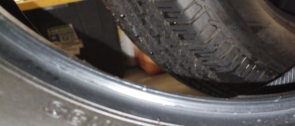

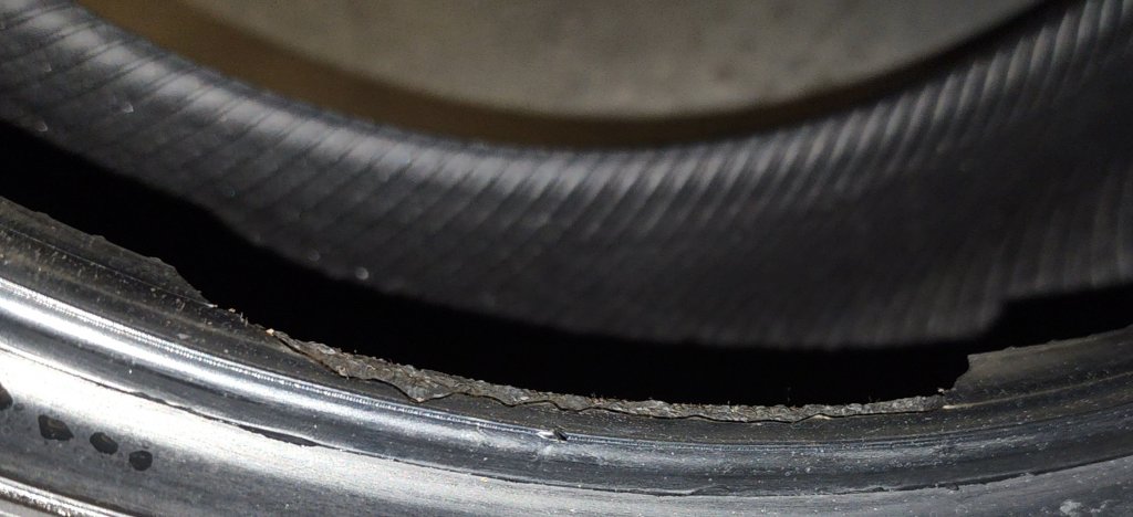

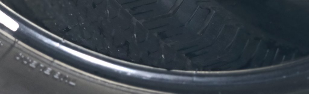

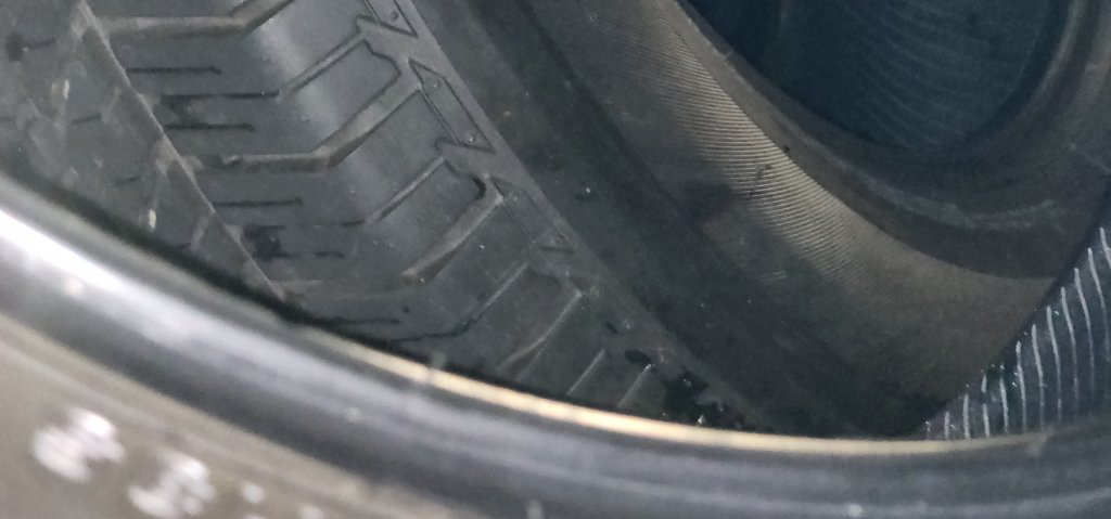

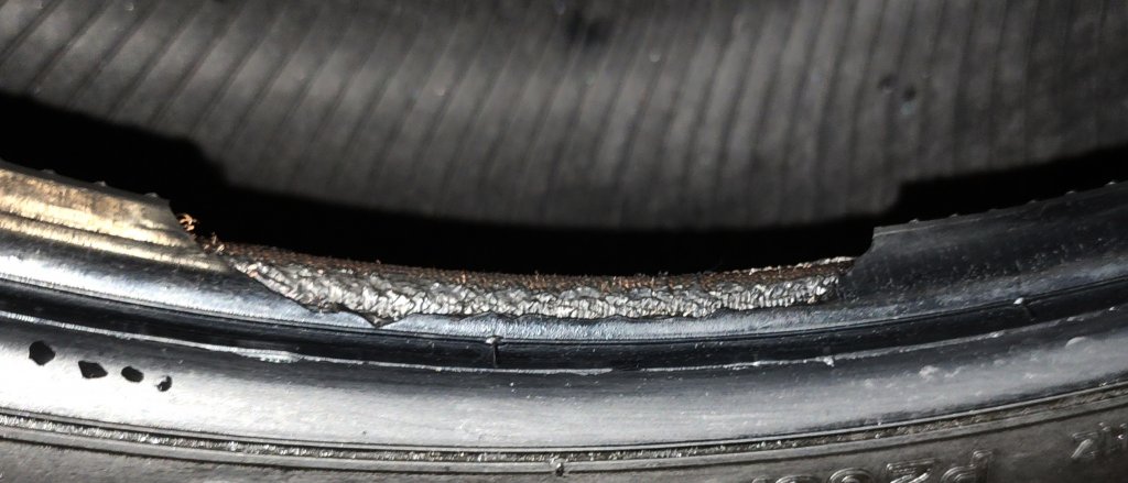

Hello GMSB Buddies! I hope all is well.
Just a quick report. Waiting on new to me spindles and axles from @AyWoSch Motors.
Also, I need your expert advise.
I would mount it I just know there is other experts here with more experience.
Got me a brand new set of take off tires from a neighbor. A kid that got himself a brand new 2023 Toyota 40th Anniversary Edition. He had 11 miles, drove straight to a shop removed the factory rims & tires and added some kind of lift kit...
He traded them for a cheap shotgun to my neighbor.
My neighbor sold me the 4 tires for
$300.00... Bridgstone Dueler H/T
P265/75R17
Well, when he took them to get unmounted... I never saw it until I was going to store them for my personal truck,
one of them had a blemish.
The pop tire shop denied the damage... :mad:
Anyway what do you guys think?
Your honest and serious advice is always appreciated!
Be well and stay safe out there.
Best wishes to you and all of your loved ones always!
