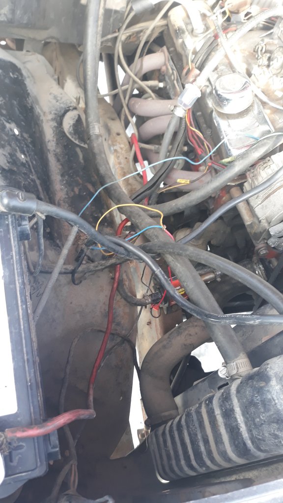

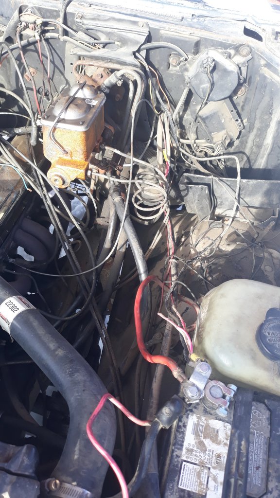

Based on what I have seen so far, there is a possibility that you shouted the blue wire that is coiled up, which could have blown a fuse that powers the dist. Need to check fuses to cross that off the list.

Was the blue wire coiled up like it shows in the pic, or did you coil it up? One of the first things we need to do is replace the connector on the end of the red wire where it connects to the Dist, and trace it back to where it comes from. Leave the yellow wire that goes to the fuel pump lose for right now. We will run a new wire for the fuel pump so it's not powered from the Dist.
I'm thinking we start with getting the starter to turn over first, then we get spark, then we deal with the fuel pump. Unless you want/need to do things in a different order. Your project, so you let me know what you need to move forward.
You should have a fuse labeled "IGN" we need to make sure it is good.

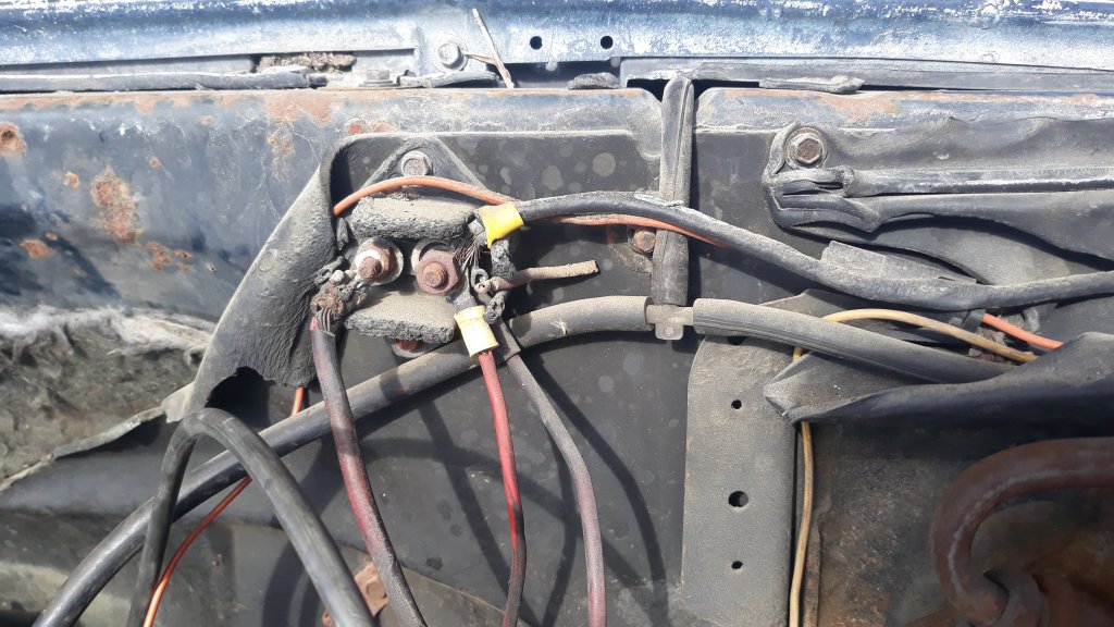

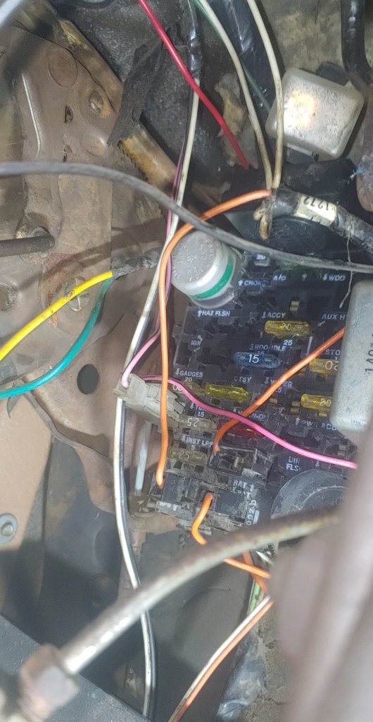

I had to work late, sorry. Would you please check to see if you can get 12 volts on the red wire at the distributor, with the key in the start and the run position? I'm going to study the wiring diagram tonight and check back in the morning. A picture of the fuel relays and terminal block/fusible link on the firewall and a picture of battery connections would be helpful if possible too.
Sorry for the delay. I got the pictures. I tested and got zero positive connection, however on the on wire I did get 12c volts of ground though.
I think that the picture I got of the fire wall is the fusible link that you're talking about but I'm not positive. The fuse box was under the stering column. A couple of the 30 amp fuses are blown, I will try and get those replaced as soon as possbile. could have something to do with the problem for sure

this is not an 85 so your fuse box may be larger, but its down by the e brake pedal(see the ratchet for it on the left) at the base of steering column by the firewall. its annoying spot but you should be able to get a good shot with the camera at it then look at the wires and see whats going on from a dis
this is not an 85 so your fuse box may be larger, but its down by the e brake pedal(see the ratchet for it on the left) at the base of steering column by the firewall. its annoying spot but you should be able to get a good shot with the camera at it then look at the wires and see whats going on from a distance
Thanks. I found mine rigjht by the steering column like you said
