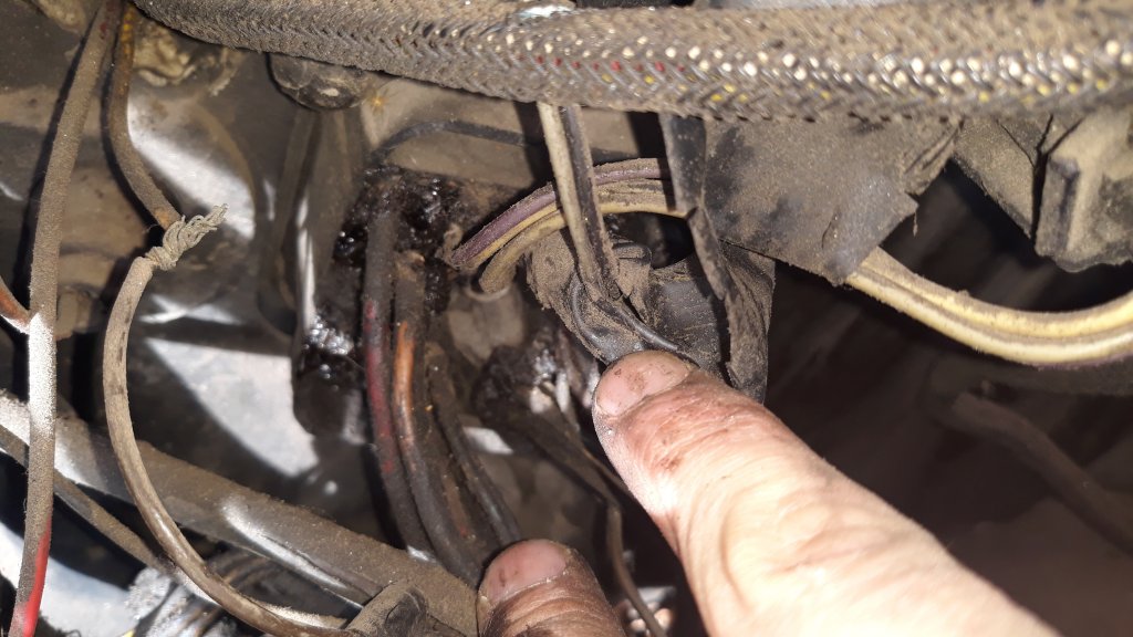

On the wiring. In your most recent set of pictures: First picture, do I see bare wires off the positive terminal by the washer bottle? If so that should be addressed. In your third picture that thing is a mess. Especially the wire on the left stud... That end is so far gone there is no way power goes though that thing properly. I would cut the ends off all of the wires that go on both of those terminals and crimp new eyelets on them and reinstall. Looks like one of the eyelets on the right stud is to big as well.

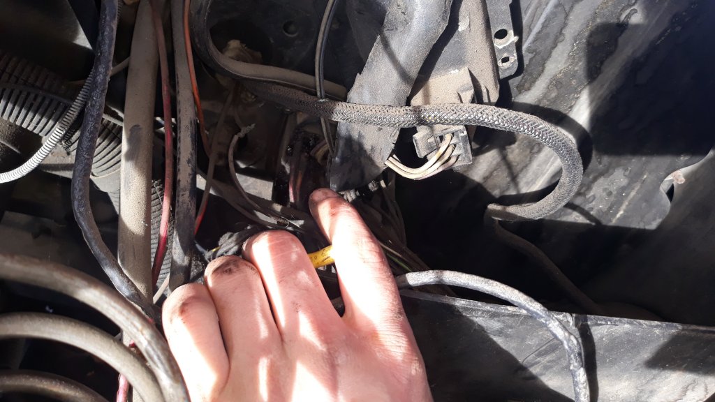

Haha, I was wondering what that extra oil filter looking thing was for. I guess that's probably the pump. Once I got the thing running sounds like I should jump on that pump next
Picture 1, The wires shown are black, I don't see any that are bare.

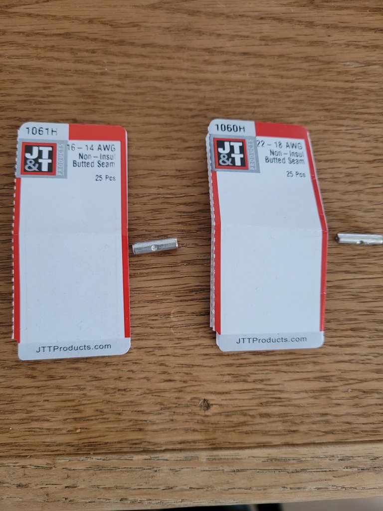

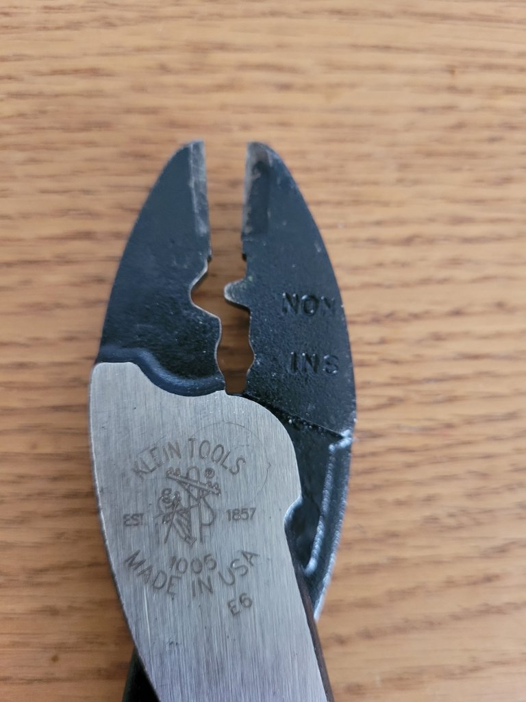

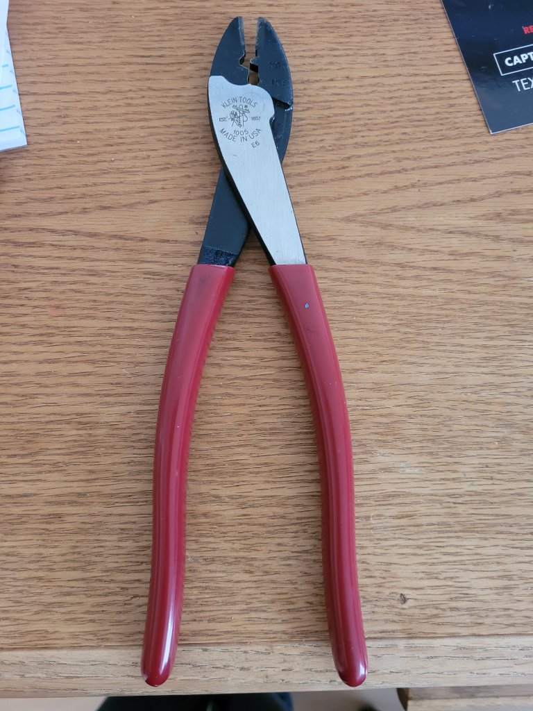

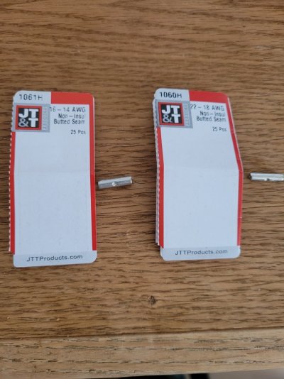

Picture three, I'll order a better crimping set. The one I got deals with smaller wires.

I tested the wires going to the dist. The yellow one goes to through the firewall (I think I was wrong and that it is the yellow one that goes to the ignition but not sure. I follow the red wire and it goes into a a rather large wrap and all the wires come out connencting to what I have a picture of below. all the wires down there seem to have a pretty good connection but do to how many wires there are I didn't follow perfectly which one was the red that goes to the dist.

Also I failed to mention earlier, the secondary battery has the main wires going to the plow, as well as the mess of wires to to the back engine.

Yea, that's a terrible idea, and would never do that.
I really don't know how many amps that pump draws, but lets say for the sake of discussion that it's 5 amps, going to the one wire that powers the distributor. That one wire was never meant to power a motor, doing that is going to cause a voltage drop in the wiring to the distributor, so it's getting fed lower voltage than it should be.
The best way to wire an electric pump would be though a relay, second best would be a key on power off the fuse box.
Also in the current set up not only is it likely that the distributor is getting less voltage than it should, it's very likely that the fuel pump is seeing reduced voltage. Lower voltage to a motor, increases amp draw, increases heat, and shortens the life of the fuel pump.
This is what I use, I prefer the naked butt splices and shrink wrap to keep everything clean. The connectors with the colored plastic insulators look crappy and don't crimp as well. One more tip, when you are replacing wires or connectors it is less confusing if you correct one wire at a time instead of pulling everything apart all at once. Start where ever you feel comfortable. If it's in your budget, a colored wiring diagram as reference will save you time and aggravation too. If you have the option of diesel diagram and regular, get both. That way one diagram shows what you have and the other shows where you want to end up. It will help you know what to remove and what needs to be changed.
The dual battery setup was to power the glow plugs on the diesel engine for starting, if you are going to use it as a spare battery it will be wired a little different than the diesel configuration. Or the second battery and the extra wiring can be removed.
