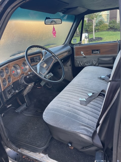

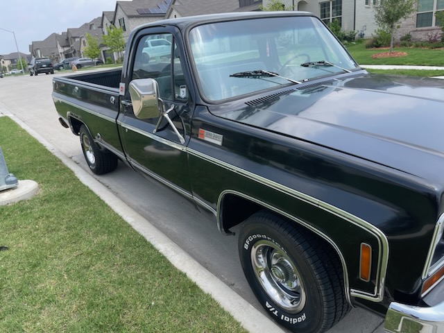

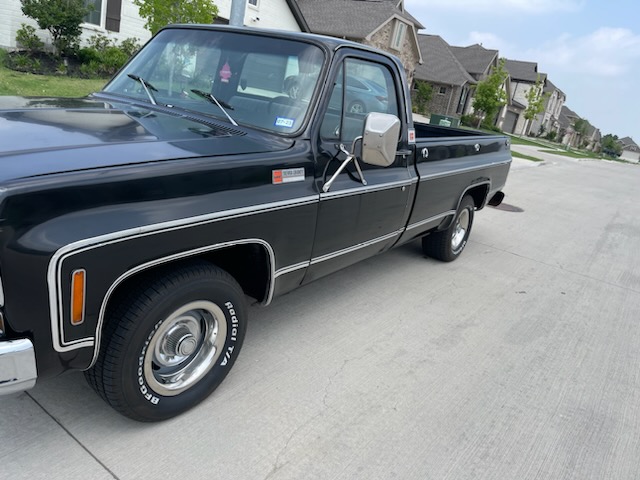

No problem guys here are a couple pics for you

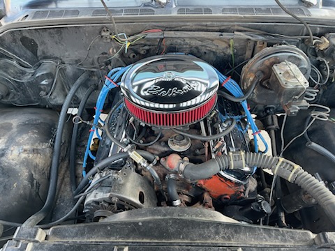

That's what I'm talking about. Looks like a solid truck. Your plan sounds good except for the single plane intake. Unless your using an EFI dry manifold you will be much happier with a good dual plane like the Performer RPM for a daily driver.

Thanks for the encouragement and replies, dual plane will be the way to go (edelbrock performer air gap looks good), i am used to using single plane intakes on the strokers i have done in the past. I agree the drum brakes will stop it fine i just hate hate replacing brake shoes lol.

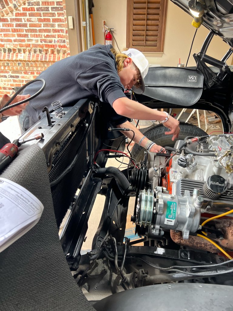

Welcome from DFW Texas! My son bought his at 14 and loves it and the project (now 17)

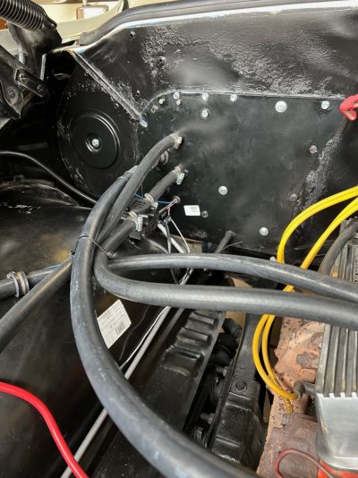

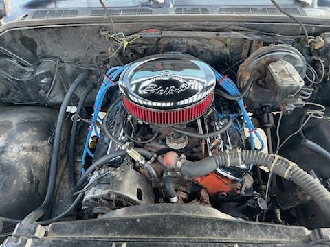

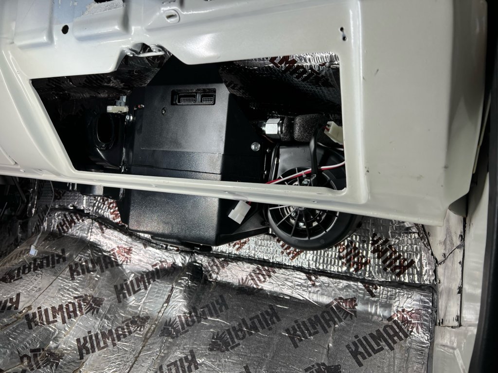

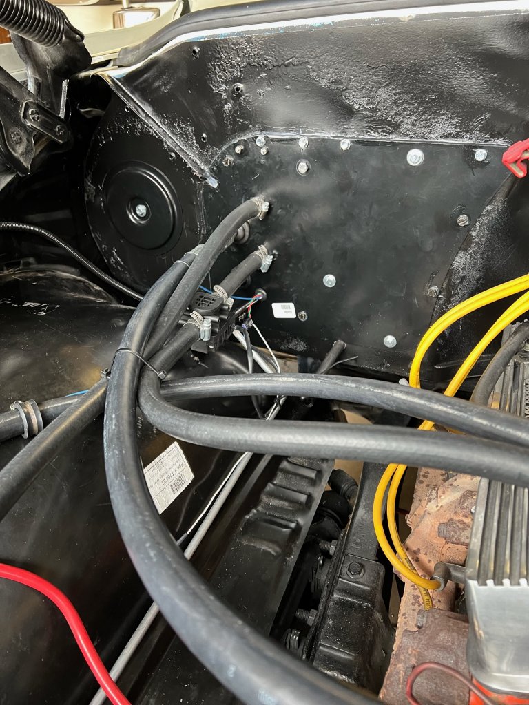

May we suggest vintage air for the AC system. It’s made right here in good ole San Antonio and has the best customer service/support for us DIY folks… turn key system that works flawlessly for less than 2K last I checked. We are just a couple of shade tree mechanics and we did the AC in just a few days over thanksgiving.
