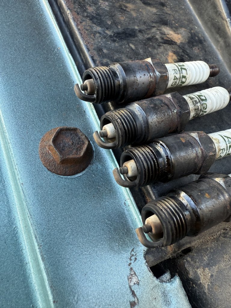

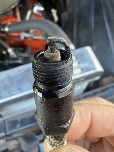

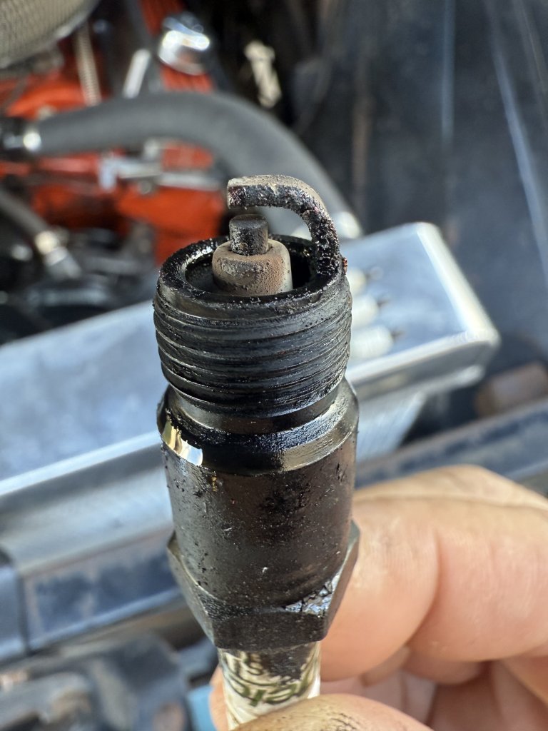

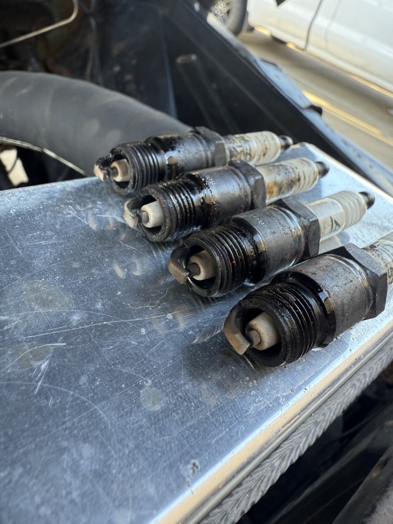

Ive consulted the online plug color guides, thought Id see what yall thought. Lot of timing/octane changes with these on. 5 and 7 stand out the most

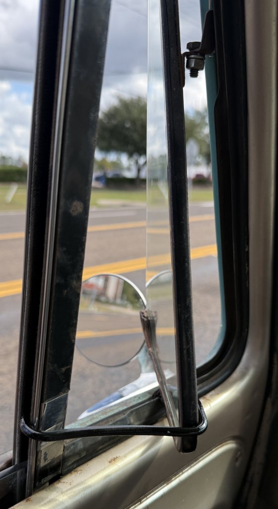

Tired of the vent window not staying open cause it’s still 89 degrees here so first I drilled the rivet out and put a nut and bolt there hoping it would have more tension but that didn’t work and now I got a huge ****** bolt there. Maybe I’ll put a rivet back.
Bent a big ass nail and painted it black, the wind holds it tight lol

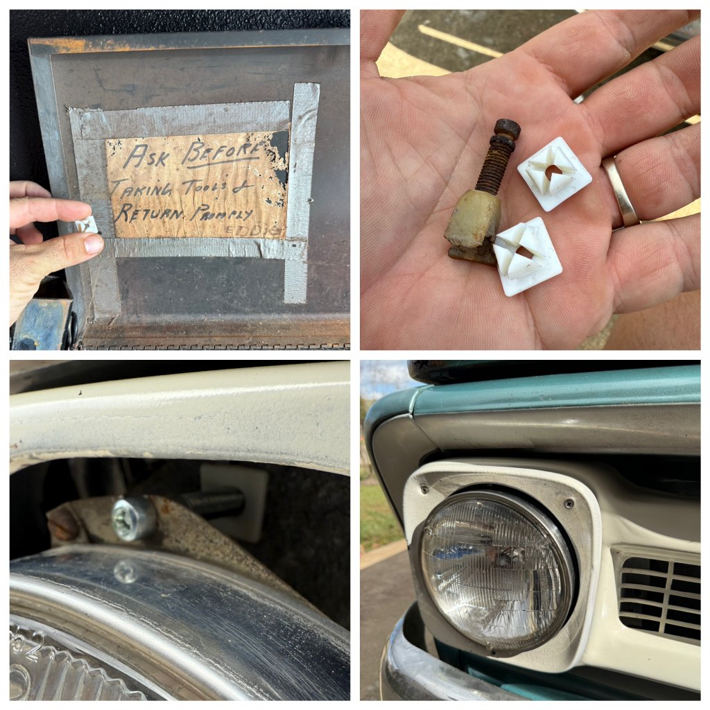

Also got the headlight adjusters replaced, the GM ones on the rack at O’Reillys were too big so I found these what I think are license plate holders in my wife’s late grandfather’s toolbox. Eddie comes through again. Going to aim the headlights tonight on the garage door.
By the way, never did lose rear tail lights again, not sure what it was, but under dash fuse block and harness is definitely on the list

There's a spring under the assembly inside the door that provides tension. Snug up the nut and the spring will apply more pressure inside the door. I think the nut is 7/16 or 1/2. Unscrew the door panel to access it. Remove the handles first, of course...lol...
