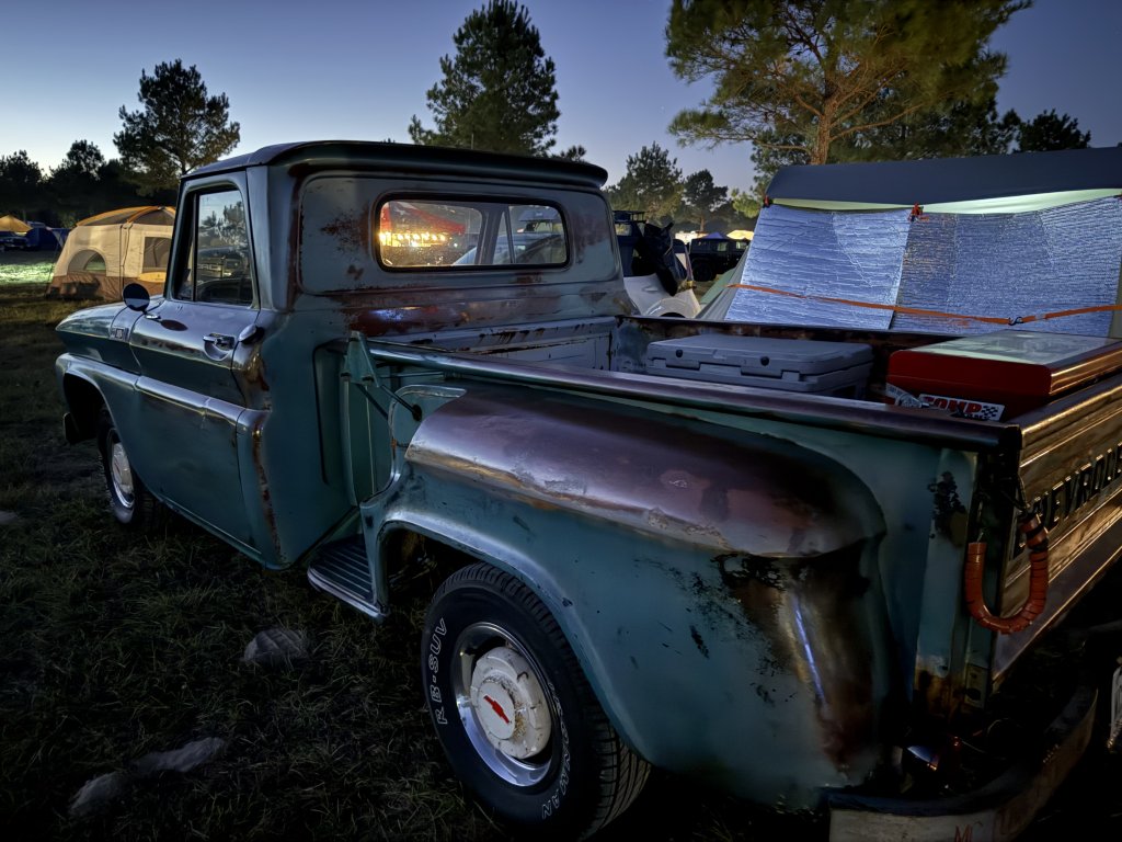

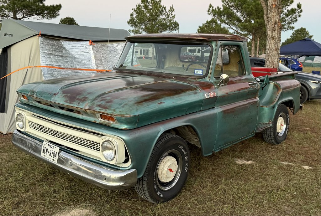

52 miles into my trip, sitting in traffic. Thump cam thump

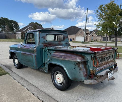

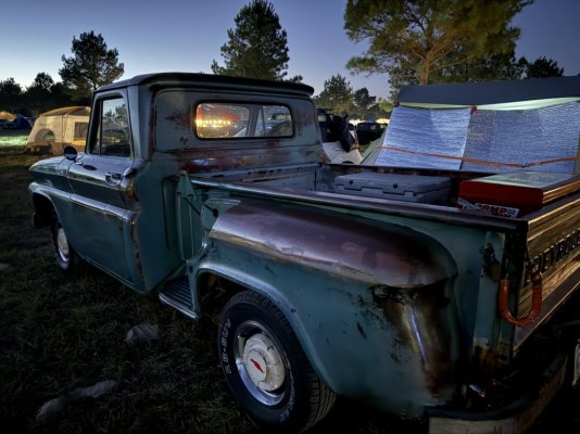

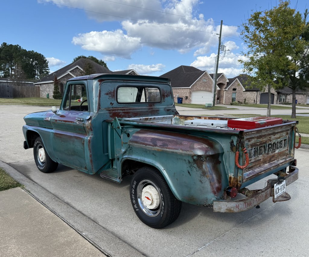

Made it, 123 miles, the last 30 miles at 78-80 to see how it would act. 200 temp gauge 40 psi 3500 rpm like it was made to do it

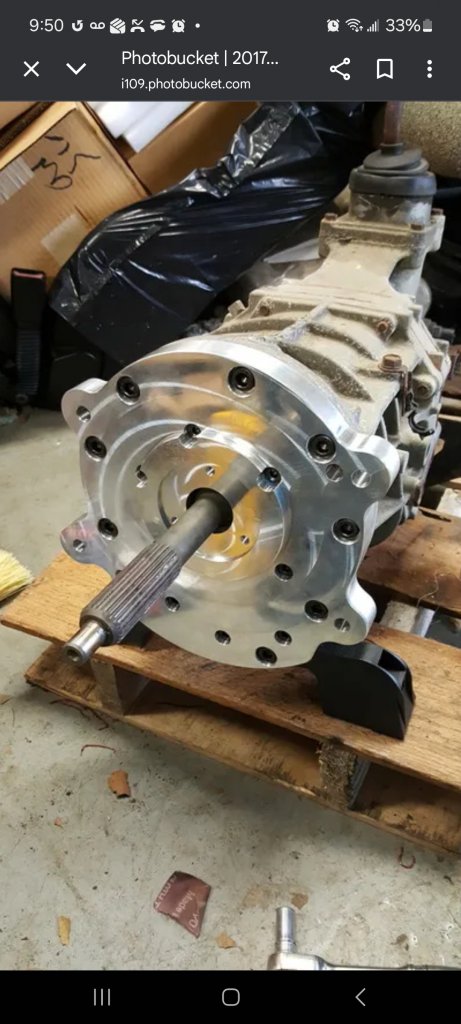

A lot of people sleep on them because they got a bad rep but I have a S10 NV3500 in mine an its been great for 8 yrs now. The S10 version is closer ratio an uses the 350/4l60 size yoke. One of the better things I've done to it...
35,429
44,745

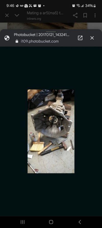

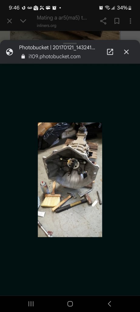

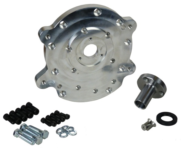

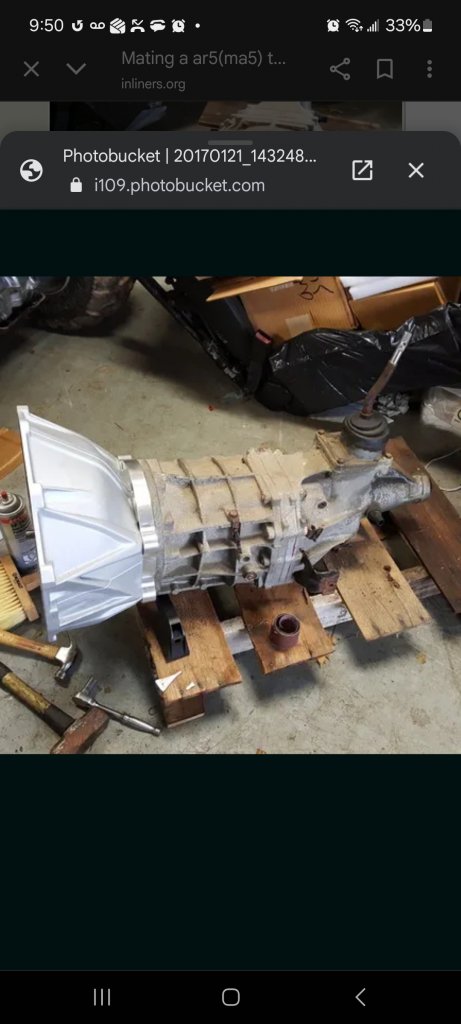

One option I recently became aware of (thanks to the Express van guy on GMT400.com) is the AR5 swap as a good candidate. The Colorado AR5 trans seems to be much easier to find than an NV3500. It can be used with a 4L60 bellhousing and and adapter plate.
10,175
19,682
I like this better was looking at this a while back for one of my projects
