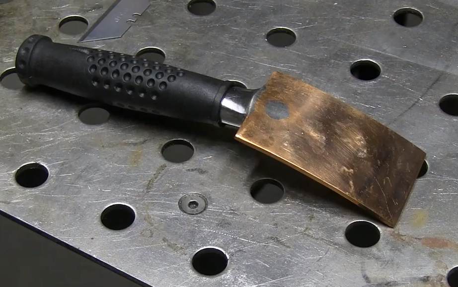

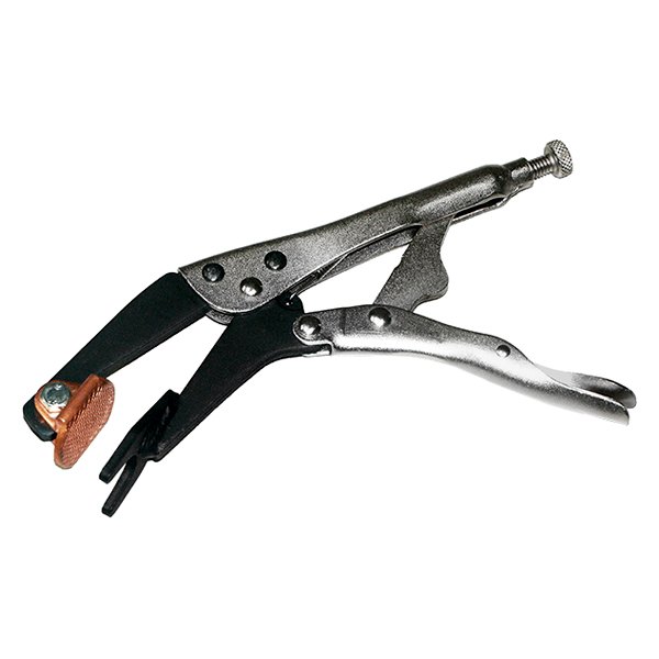

I have a redneck copper spoon for welding holes in sheet metal. It's a 1" copper pipe flattened and folded, then attached to a handle. I also have the spotweld clamp version (store-bought). It keeps the weld flatter and gives a backing and heatsink to avoid blowouts. I need to take the copper to my blacksmith friend so we can heat and hammer the layers together better - but that is a winter project/visit. The picture is a store-bought version of the spoon, but you get the idea (mine is at home).

Use some copper or aluminum to back the area up, works as a heat sink and helps with bridging a gap.

If I weld, I use a Miller 211 turned way down and a 24 wire with a peice of copper behind it and use compressed air or a wet rag to keep the metal cool

I have a brass, or maybe bronze, slug around here for that exact job, backing up the hole. I'm in the welder up camp.
