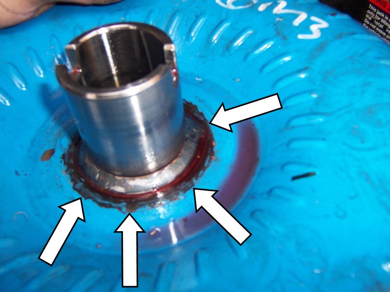

I been talking with HRPC on this one, working on a short(6") tail th350 has a leak from inside the bellhousing area. HRPC told me of course the main things are your front seal and such, checked em out seemed fine to me.
It's not too old of a seal BTW, maybe a few years if that. Anyways, got some pics...
noticed this chunk gone over the pump, not sure if it has anything to do with the leak or not.
tried to get pics of the bushing..
TC snout, nor ridges, but there is one spot I can catch my finger nail on, it's about 3/4 inch from the top(the part that goes into the pump gears)This is a new TC only 2-3 years old I think 2.
Now what I was telling HRPC was the thing had the kickdown cable locked in the passing positon somehow, wasn't even hooked up to the carb, and the car backed over a creek bank as well. I'm pretty sure going over the bank has alot to do with it, and caused the paint scraped off the TC...
