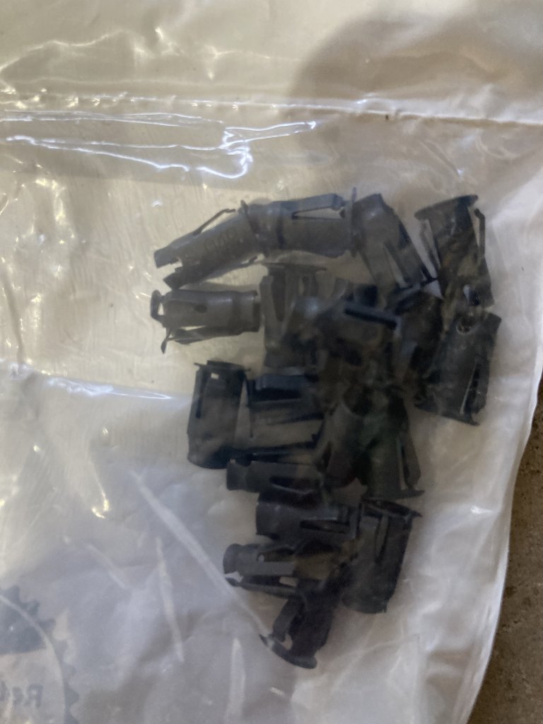

I used these on my c10, worked like a charm... solid, no vibration.
