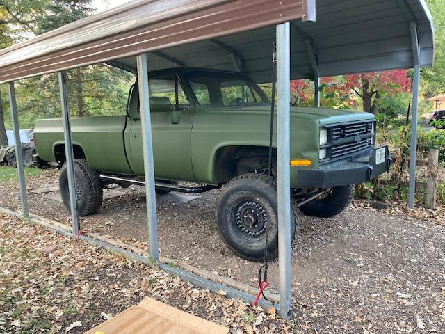

How much taller is the frame and does that all equate to lift?
Or in other words what does this look like for lift? Those are half worn 315-75-16 tires for reference. Rear is 4” blocks under OE springs.

All lifts are somewhat different, but if the question was if the exact same springs were swapped back and forth from a k20 to a k30, I believe the difference is between 1-2” difference in height. Most say a 4” lift is where one should be to run 33s on a k10/20, but a k30 needs about a 2” lift for the same effect.
