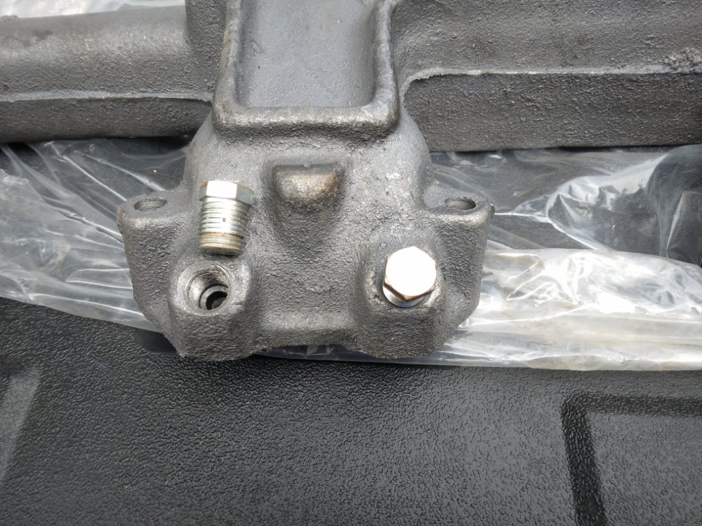

Pipe plugs do not match. What you want are inverted seat plugs.
Coat the threads with some anti-seize thread paste. The inverted seat will seal the plug. They are sold by tube size, so 1/4" tube are 7/16" threads

are you saying the plugs that came with the manifold are a bad choice???? checking to see if Nappa has what you suggested
Are those plugs, pipe thread? Do they have the inverted seat like the picture I posted?

Napa will have the correct plugs. Yes the people that design manifolds are engineers. The people that package the parts, not so much.

the plugs are solid w/ a flat bottom....nappa "search" didn't show anything, so I'm gonna call

Many years ago I just cut each pipe and removed the fitting. Then I fit a steel ball bearing into each fitting and screwed it back in place. It was still fine when I sold the car.

Finding a correct fitting can be a nightmare. I had some ramshead manifolds with air injection. Used solid pipe-threaded plugs. I put some anti-seize on them, screwed them in tight, and then cut them off flush with the manifold. Looks great. I should mention that I installed them backwards, screwing them in from the inside of the manifold. The threads are undamaged and they can be easily removed to allow for re-installation of AIR pipes if need be. Didn't want to damage the vintage GM parts. Good luck!
