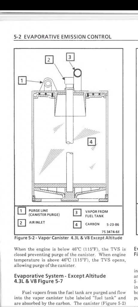

make sure the lines are hooked up correctly at the cannister and throttle body.
gas cap is supposed to have a check valve in it to relieve pressure or vacuum. so it could be a bad cap.
