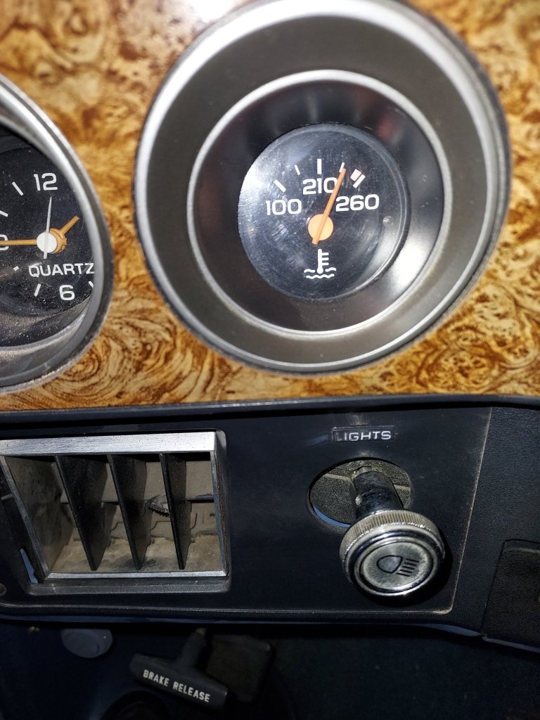

Running the truck on it's 2nd break-in.
Running between 2500-3000rpm.
Getting code 44 (lean exhaust).
I assume I need to increase fuel psi at regulator. I haven't set idle timing yet, I was going to get her broke in 1st?
I thought my Maddox gauge said 14psi at location just past fuel filter though...
She is Running hot, but in the garage with back end out, so no air other than fan and aux Running. Gets above 210.
What hits ya? Double ck psi, should I increase yet...don't worry about excessive heat going 70mph in garage?

How many minutes you got on it? It very likely is lean held at 2500 rpm,no load,I've had engines get the exhaust redhot on cam break in. If they are too hot I let em cool and go at it again. After break in oil is changed( I change it hot immediately after cam break in) anyway break in the cam,time it,tweak it see if the problem doesn't just go away on its own. You are running in a very unique set of circumstances at cam break in.
Awesome, gut was telling me that.
Ran twice so, 20 minutes total.
Definitely getting hot.
Will do last one today. Drain refill.
Set idle timing tomorrow after warm up. Stock is -4, and think edelbrock says -3 for cam.

Did final break-in. Truck ran great. Will drain and fix some leaks (see Betty Blue build page). Aluminum coolant fittings and oil coolant hose. Arugh
Idled in park at 740ish. Forgot to ck in gear.
We'll mess with cking base timing and exhaust lean code after a little leak fixing.
