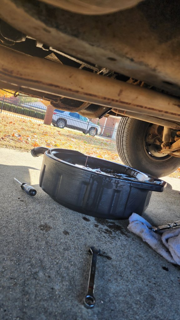

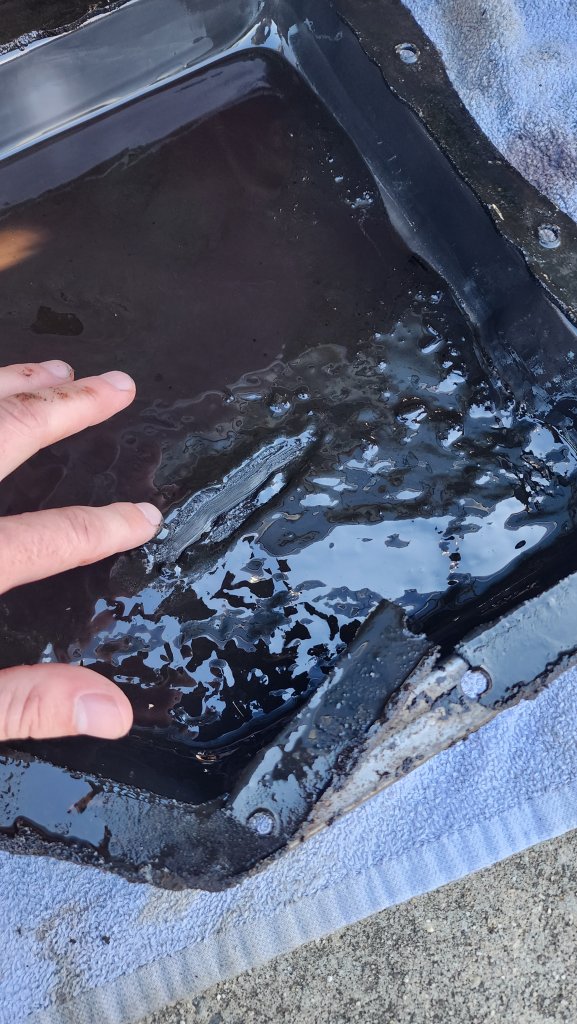

Whats the color and odor of the ATF

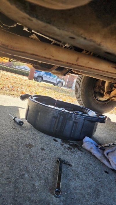

I see that connection under there, gunna clean up the tranny fluid and filter first

Ok, well transmission filter and fluid definitely needed changing, but it still shuts off by itself in idle now. I'm thinking there may be water in my gas....

Trans sludge aside (that will be a current or future issue for sure), start with the simple stuff.
Verify fuel supply from pump. And if it’s good, run it off a gas can to verify or isolate any issues with the tank/water/fuel pickup etc.
timing, if you don’t have a timing light, you need one and verify initial timing and (presumably) vaccum advance is working properly.
Also check vacuum for leaks but not likely if it runs fine then doesn’t.
That’s where I’d start as well as verifying it is or isn’t spitting fuel the same into the carb when it’s running good and again when it’s running poorly.
Good luck!
