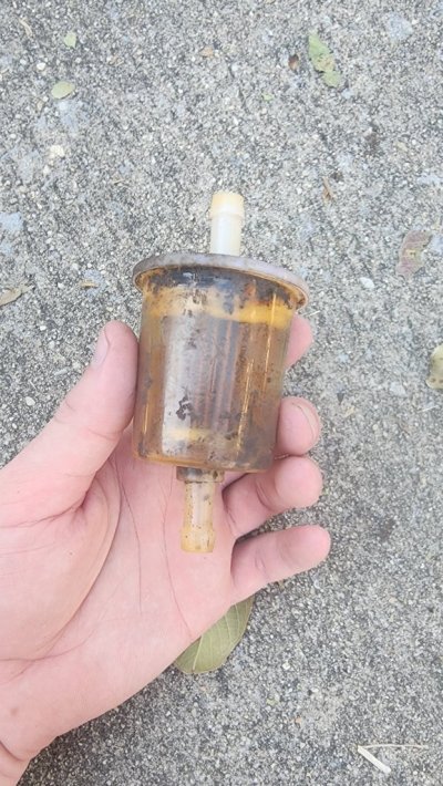

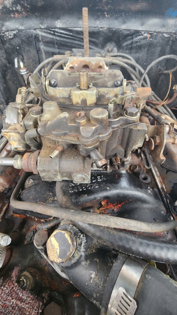

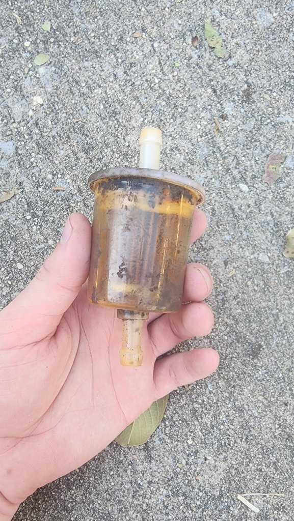

Yeah I've already changed the fuel filter once, will probably have to do it again after I replace the tank. It's ok though, the fuel filters are mighty easy and cheap to replace. Then after I get a new tank, I will be focusing on cleaning and rebuilding the carb.
Bextreme04
Supporting Member Army
May 13, 2019
4,826
6,530
350-4bbl
There is also a fuel filter inside the inlet of the carburetor. You need to remove the fuel line and then the big rusty fitting between the fuel line and carburetor body(where you can see it says "Filter"). I bet that filter is also pretty grungy based on the way that in-line filter looks.
I would wait until you are replacing the fuel tank and fuel neck, then when the old tank is disconnected and the fuel lines that connect to the sender are disconnected, disconnect the fuel feed line from the fuel pump and blow compressed air back through the fuel line to clear all the junk out. Make sure you buy and new sender also. If the tank is rusty and nasty, the sender will usually be in even worse shape. I have to replace senders way more often than fuel tanks.
Definitely change the filter inside the carb. If that filter has not been changed yet, that could be the sole source of your power loss.
