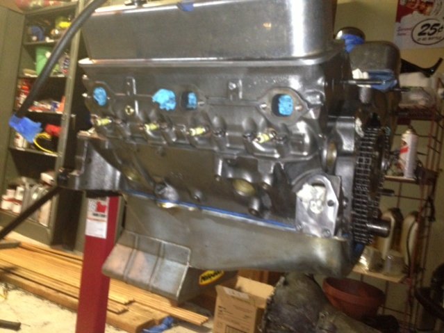

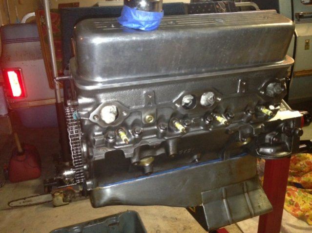

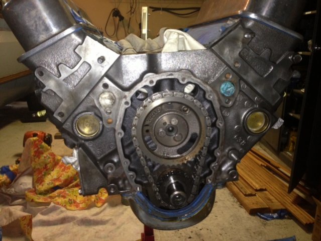

UPDATE:
Block and heads are completely down to bare metal.
See the pics.
POR-15 engine enamel BLK is on order. will paint this weekend.
chengny
Feb 22, 2012
4,084
1,029
NH
Jerry
K3500
350/5.7
Ya done good son. I am impressed.

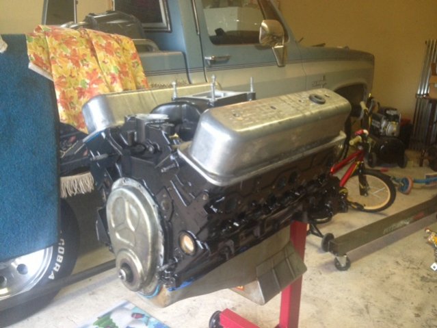

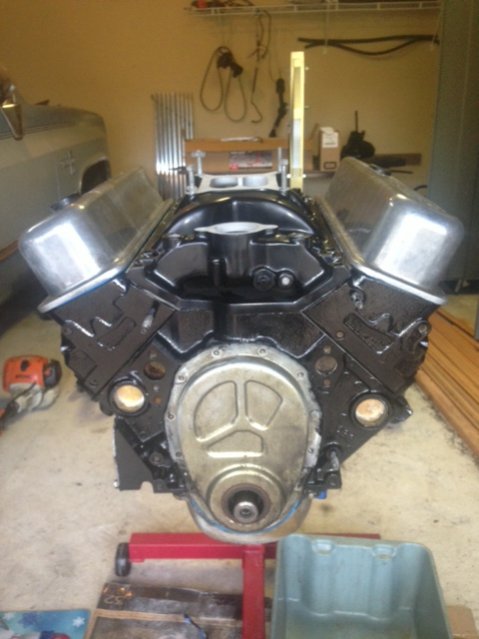

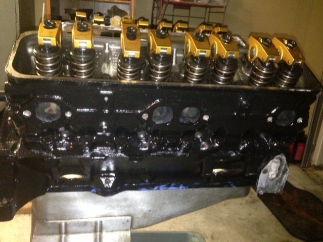

Hey Guys,
Here the update on the engine..
See the pics.
Sorry it took so long. havent had time to post the pics.
chengny
Feb 22, 2012
4,084
1,029
NH
Jerry
K3500
350/5.7
Looks sharp - and it will stay looking that way for a long time.
