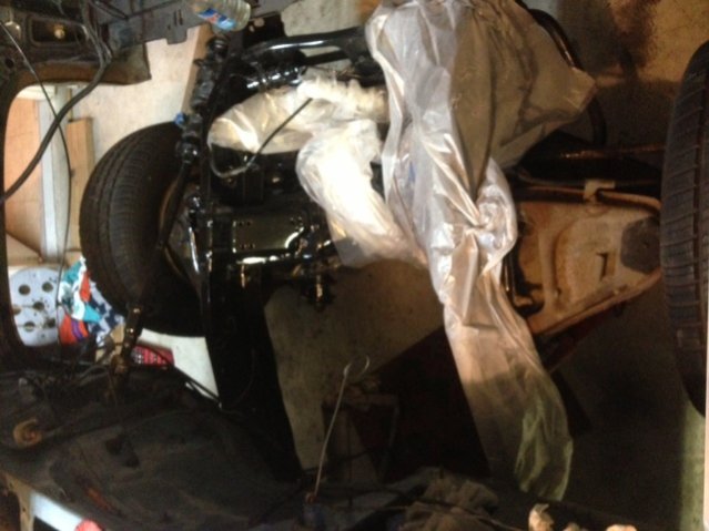

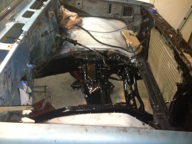

Good deal. I also used the por-15 to paint the frame on the inside of the engine bay. Por-15 has engine enamel for the engine and por-15 for the frame and other parts.
I was re-doing the entire engine bay before i send the truck out for paint. But, I got tired and wanted it done. So, I sent the truck off to the body shop to re paint the entire inside of the engine bay (compartment). It had a a rust hole or two, thats gonna get cut out and replaced with new metal.
Truck showed be ready this weekend or next. gonna be oringinal paint color scheme.
Here;s pics of the frame that I did.

Looks good, you got to put some finished pics up when it gets back. So you were brushing all that to? I plan to to the entire bay also. I just am no sure how to attack the few rust holes in the firewall.

Yea, brushed all of it. that por-15 dries harder than a rock!!!
If you wanna do it right, have them cut it cut and replace with new metal.
Not sure how "bondo" will hold up. I jus basically said if im gonna do it, im gonna go it right and not have to worry about it every again.
I got fender wells powder coated along with intake manifold, pulley brackets, alt. bracket, and other various parts.
