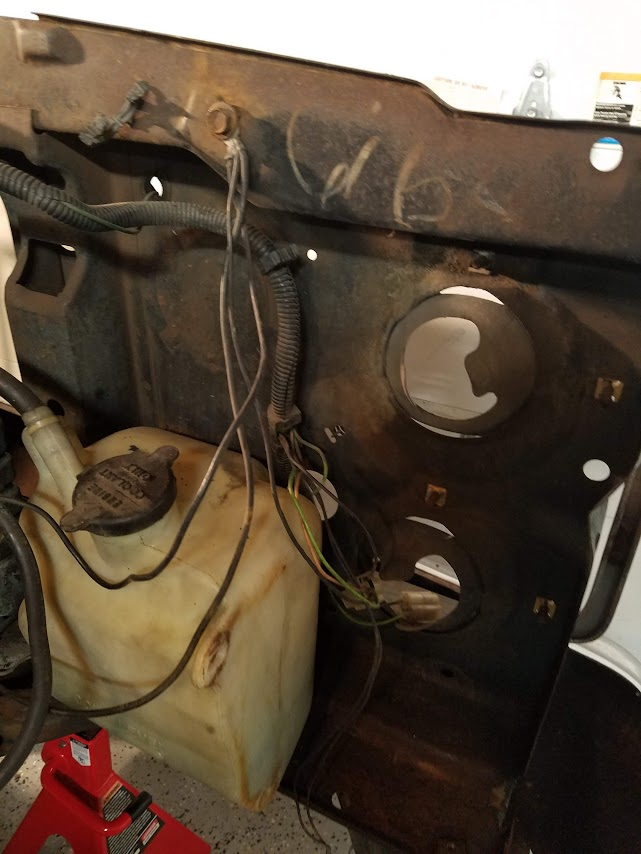

where does the small wire get landed? it wont reach to core support or frame. I will happily extend it if needed. But after dismantling stuff over 3 years some sh#1 gets forgotten....any help would be appreciated

I believe it goes to the fender. Should be a nut bossed hole in fender on the side for it if I'm not mistaken. I can look at the 85 to be sure

Core support.

Thanks. I had 2 brain cells that said frame, 2 that said fender , and 7 cells that said core support. now i had a dim light go off an maybe the old battery had the - terminal closer to the core support.....that would explain the short wire.

Before I posted my response I looked through my photos but didn't have a good one of the battery and the wire, but the one I had showed the wire going towards the front. I ran out of time before going to work to get one of my setup. It looks like you have a photo of the location to bolt it to, so you're good to go.
