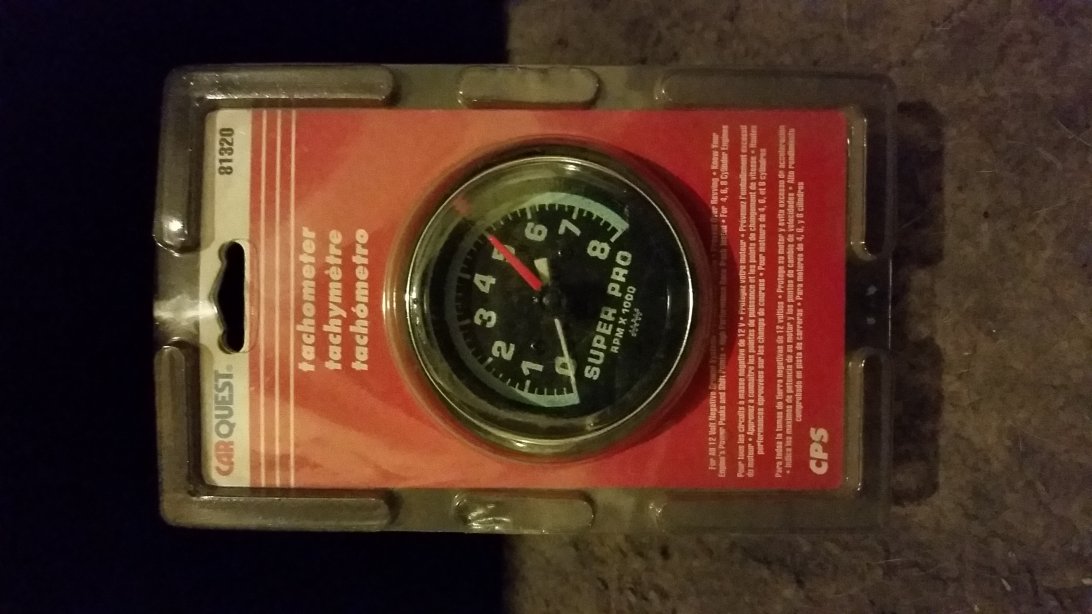

Probably by the weekend. What's the cheapest acceptable tach I can get at autozone? Or I guess I could order one from summit
I got this one for $40 at Carquest.
I assume it does the job or you wouldn't have mentioned it. Where did you mount it?

I had one like it before and it worked fine. Couldn't locate it so I bought this one. Haven't mounted it yet. The column rotates with the shifter, so figuring out a different mounting spot.
