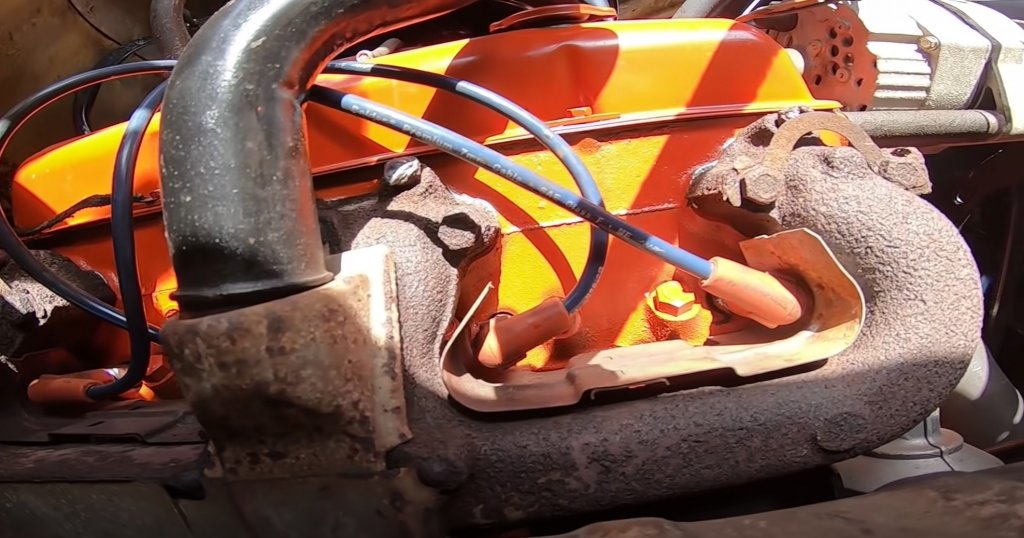

do you have the heat stove around your exhaust currently? you likely had a passenger side facing wide oval air cleaner with either a tall lid or a normal lid. with a THERMAC installed on that manifold. Most likely.
something akin to this

i believe 77 and up for sure had the ability, 75-76 i think it may have been the narrow snout which looks dumb and isnt evoking big strong confident feelings in how it looks. also pretty restrictive. I have a 77 cleaner that matches the pic i showed, so I assume 77-86 would give you a range. tbi had a diff air cleaner i think.

My ‘75 350 has the same air cleaner design, with the wide snout and a hose to the radiator support. However, the exhaust heat stove on a 350 is a little different, with the metal pipe connected to a fitting near the center of the exhaust manifold .

heres a 74 c10 with a 350 2 barrel but it has
