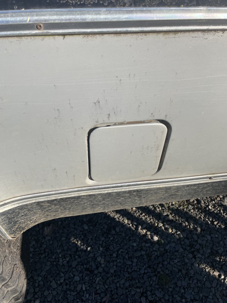

I need to find the correct filler neck so I can put more fuel in the truck and put the seat in and I’ll drive it down the road later. The current filler cap is like one of the bedside that doesn’t have a fuel door but the bed is one with a fuel door. So it’s angled all wrong and I have to use a funnel but my funnel had a crack last night and got gasoline all over my amazing(not really) paint job lol. If it is still running rich could that be the float level incorrect? Or should I purchase a different set of jets/rods. The last set I got the line wrong and ended up getting the wrong set lol. My error no ones fault but my own. So it did end up leaner than anticipated. Bextreme I’ll try and figure out how to private message you if I can’t find a closer choke cable bracket. Although it fired right up, rough but idled, with the other plugs. I’ll look into getting a new set of the ts plugs after I know it’s not running rich and won’t foul my plugs.
Sounds about right. Yes, float level can absolutely cause rich condition. Also, if the fuel pressure is too high it can push past the floats as well. If you set them to the recommended float level and it is still pushing past, you might try giving them a bit more depth so they push harder against the seat.

I have all of that stuff too... I just pulled my dual tanks from my 1980 to go to a single blazer tank.
Bextreme04
May 13, 2019
4,571
5,901
350-4bbl
Here’s what the filler neck and stuff looks like on the 1980. They are different again in the later 80’s

The later 80’s ones will have the three hole mounting for the filler neck
