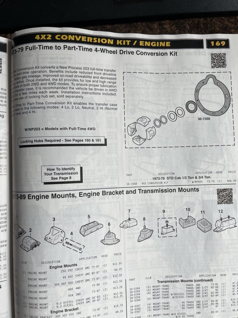

I saw a conversation kit in my LMC catalog

@telecat89 that set up is just the clutches, and is not the full conversion. If you look up the Mile Marker or Doug Nash conversion, it was a full shaft and bearing replacement. Apart from finding a used case that someone has converted in the past I have not found anyone selling the "full" conversion.
@chevdude - Running the transfer case constant 2wd means the chain and 4wd mechanism never sees any splash oil lubrication. This can lead to bearing failure over time, which is why there is a recommendation to engage and run the 4 lo from time to time - like many things I guess - use it or lose it !!..
