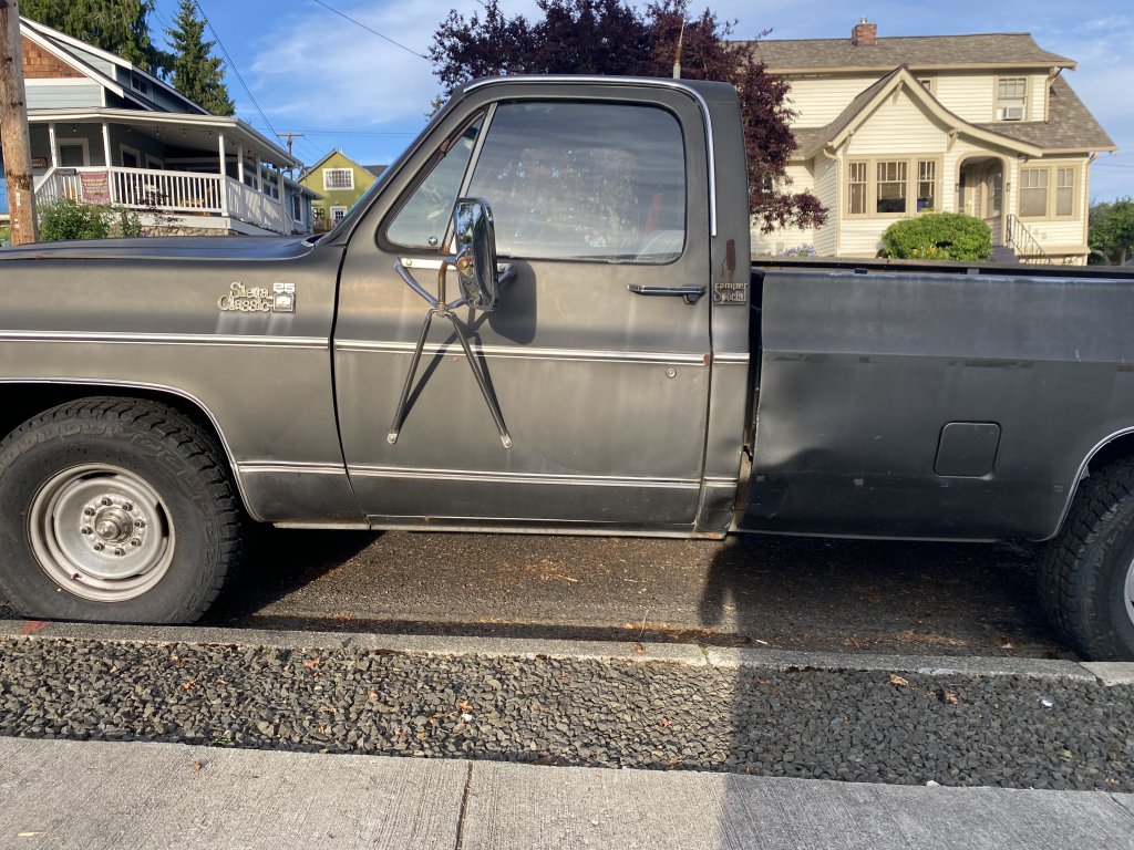

Is the door hanging, warped, closes like sht? Are the hinge pins loose?
Have you put some pex on the striker and shimmed out the bottom hinge so it closes easier?

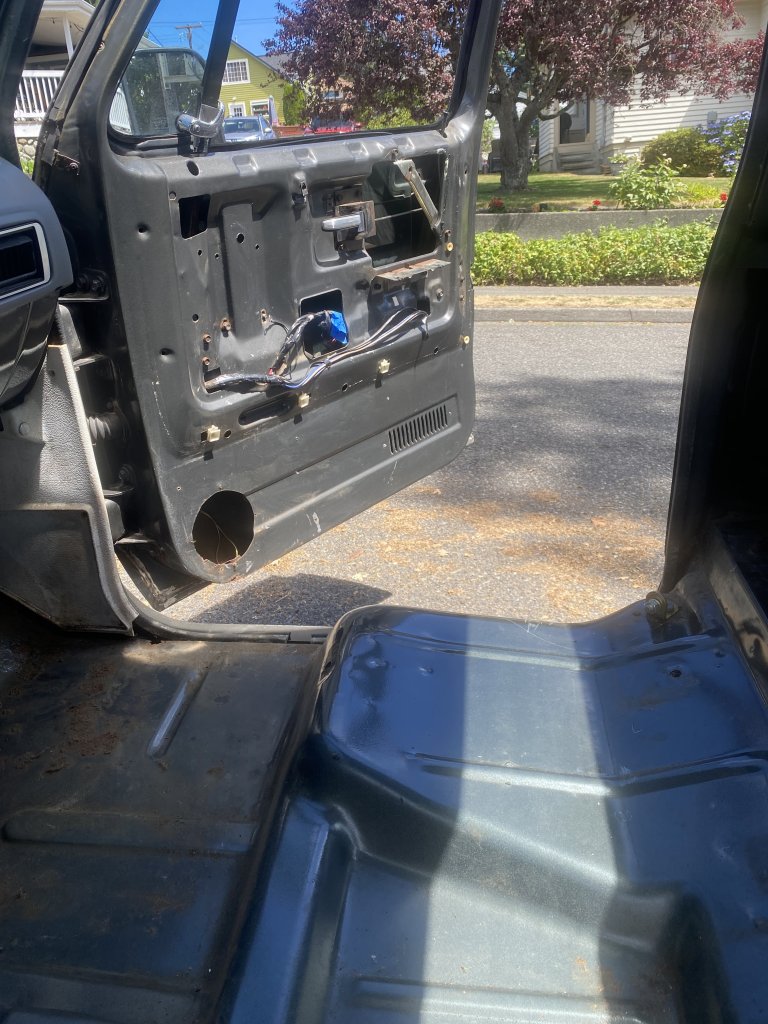

The door closes like ****, to get it to close where there’s not huge gap with sky coming through, you have to slam it really really hard. The door has some wiggle up and down at the hinges but I will have to watch while someone else does it. I don’t know how to tell if the hinge pins are loose, if there’s any movement? I don’t know what pex is. I have not shimmed the door at all. The door seems decent, other than the window channel hardware, weather stripping. The original/matching doors do have the stupid holes for speakers someone cut but I don’t think the doors are that bad, without having a reference to compare to. I will take some pictures tonight, but here is what the door looks like and a picture of the inside of the passenger door to give an idea of condition.

PEX is like that plastic lines they use for running air. Sometimes putting a 1/2" chunk of it around the door striker helps with door issues to replace what used to be there. get 10' piece with 1/2" ID at hardware store for like $4 and share it with other squarebody guys / girls.

To determine how the hinges are, with the door open try to pick the rear of the door up. If they are tight it will have minimal movement up and down.

I can see from the pic and tell from your response that raising the door at the striker by shimming out the bottom hinge will help that issue. Also because car doors only sag with age. Not unlike humans lol. It’s literally understanding gravity and material fatigue in the most basic level. Not even mechanical knowledge.
Go get your door closing easier which will ease the stress on the torn part first. Then go from there.

Says you? Yes it’s possible that everything is so worn out that it’s going to take major work. But your door/alignment looks like 99% of all squarebodys.
where unless you’re looking for a show car body panel alignment (which is better than new off the assembly line) or it’s truly ragged out, just a couple few minor adjustments or additions make a huge difference.
Buy a $9.99 set of panel shims off Amazon and do what I said. As soon as you raise the door a smidge where it’s not hanging on the striker when you close it (that flat spot worn on the top of the striker that the door latch grinds on), it will close 50% better. Add pex like the original and it’ll close even better.
All assuming the other moving parts are operating like they should.
