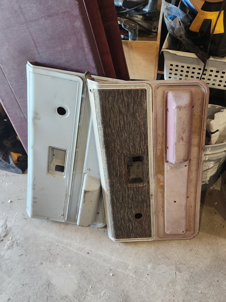

Oh and some a-hole primered one of my extremely hard to find, red+woodfrain+ aluminum etched door card. The other one is faded and the etching is gone.
Would really like to find some replacements but they dont make any remans and I haven't found any oem ones.

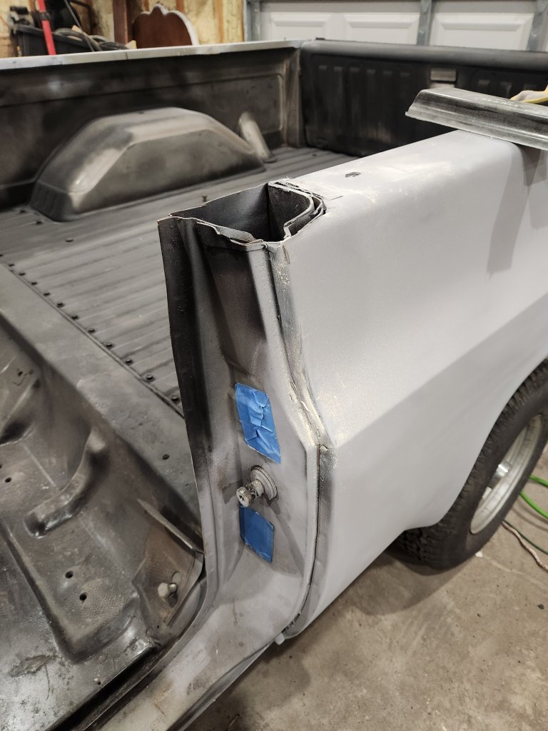

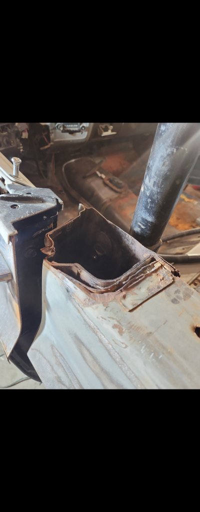

If the PO replaced both the upper windshield frame, and both doors, may be worth checking the VIN as to the year of the truck ( ie. has it been converted from a half roof 76 on ). Another way to tel is if the top corner of the bed side ( directly behind the doors ) has been cut and patched, or is original. If its un-marked, its an original full roof.
Still a cool truck !! ..

Door panels are no problem if you have all the parts. Outer trim can be polished and re-painted black. Inner panel can be re-covered with a woodgrain wrap now. Like those used on full car wraps. Cheap, easy and more choice of patterns than the original Di-Noc. Can get the dash and bezel trimmed to match...
Fat 454
Jul 24, 2012
401
636
Australia
C20 Suburban
No one re-man's any of the Super Cheyenne / High Sierra woodgrain that I have seen. Others on the board may have more info on this, as some are involved in the aftermarket scene directly ..
This stuff?(image)
Im pretty sure its a 75 though, just based off the amount of rot, the fact the t-case is a 75 and the truck has original mounts for the roll bar, which I dont think the half have, I'll check the vin tmr.
Didnt know that thoes door cards were the higher trims. If i remember correctly the dash pad said custom deluxe on it.
Why you gotta make me worry like that.
Went to my shop just to grab the vin and make sure its a 75 lol

I’d suspect those quarters/bedsides are a half cab cut down to a full top.
Any evidence of them being replaced? Does the truck have full top only rocker boxes?
randomTruckKid
Feb 26, 2024
266
194
Rockport tx
Brian
79
Its a confirmed 75. I checked the vin plate.
It does also have the progonal rocker box.
I actually have a 2nd from the parts truck.
Fat 454
Jul 24, 2012
401
636
Australia
C20 Suburban
If the truck is a combination of two, as you have said, any combination of parts may have been used to put it together.
Doesn't matter tho' - still a cool truck, and the main thing is to get it square and solid then you can get the panels to align.
I'll try and find some pics of the under floor rocker boxes when I get a chance. Would be cool to get a pic. of the top of the windshield, as i have wanted to convert a half roof I have to a full roof ....

looking at where the b pillars are, and what a janky cut down half cab looks like, it looks like my 75 blazer, aint a 75 blazer. ive seen alot of mixed info on the vin so figured id just post it.
