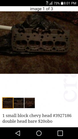

Check it out! 20 bucks!? Twist my arm first. I'll find another one...It can hang out.
Pritty good deal? I got a Jackson!
Sure I'll meet ya at Walmart, stranger on Craigslist... 3pm sounds great!
I drive an old K5 - can't miss me. ;) (He's in a Rav4 he says?) Whatever.

https://oklahomacity.craigslist.org/pts/5998397387.html
