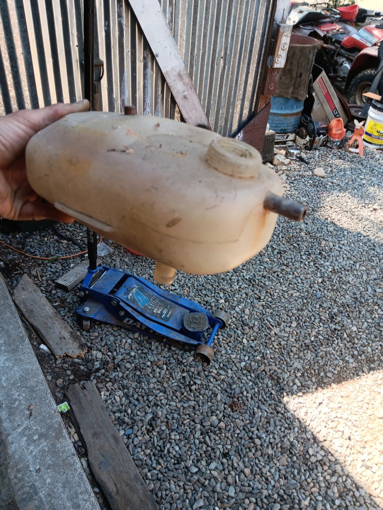

Growing up my dad bought a 90 Cherokee and have lots of memories in that thing. These jeeps are great! 91 is a good year. First of the normaler cooling system, no stupid plastic bottle. You can easily retrofit earlier ones by swapping a couple things over. Overall the last of the good stuff. The hoods are heavy Chevy! Lol
Plastic bottle? Mine has a plastic overflow reservoir, is that you're referring to? The cooling system does work really well for a system that runs hot by design. It holds steady at 200 on the gauge even in triple digit heat. Only when idling at traffic lights does it creep above 200 but the electric fan kick on and it stays there, as soon as you start rolling again it goes to 195 and back to 200. With 217k on the clock, the engine idles cold at 60psi and hot at 40psi oil pressure. Yes, the hood is heavy, but the rear hatch is lighter being made from fiberglass.

Plastic bottle? Mine has a plastic overflow reservoir, is that you're referring to? I belive so. I'll send a picture of a bottle soon
I belive so if it looks like this below.

During the years my dad changed thus bottle 3 times and replaced faulty cap 3 or 4 times I remember buying one in reno on a trip. That dodge dealership had a nice flat fender in the showroom. On 3 occasions engine overheated close to home. The ecm would shutdown the engine when overheated and it was downhill so we coasted into the driveway each time lol

Now that I think of it, the overflow bottle on mine had a plugged hole and I didn't know it. I always had to check the radiator to make sure it was full. Then, I bought a new one and when I pulled the original one out I noticed it looked different on the bottom. Took the air nozzle and it wouldn't allow air to blow through. Well no wonder the radiator wouldn't stay full and sometimes it would get a little hotter than I'd prefer. After installing the new bottle the radiator stays full and it definitely does not overheat anymore.
