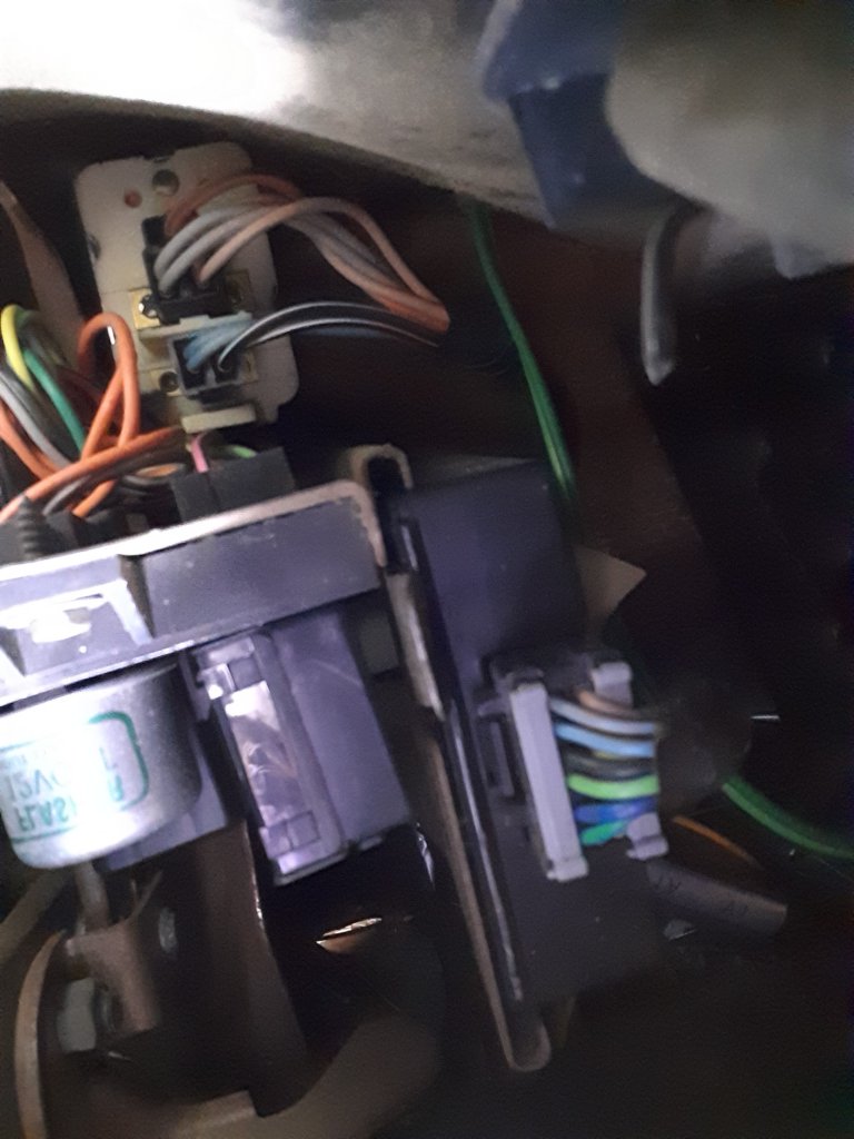

So is the white connection the door lock relay from the bottom?

upper left corner of pic.

They are very expensive and hard to find . Mine just clicks and the door locks randomly work haven’t figured it out yet

Get a door lock relay from a mid 90s GM car or truck. Make sure you get the connector and several inches of the wire.
The wire colors will match up with the exception of a black wire. Since the factory relay grounds thru the mounting bracket, you will need to ground the black wire to solid metal. Problem solved.
