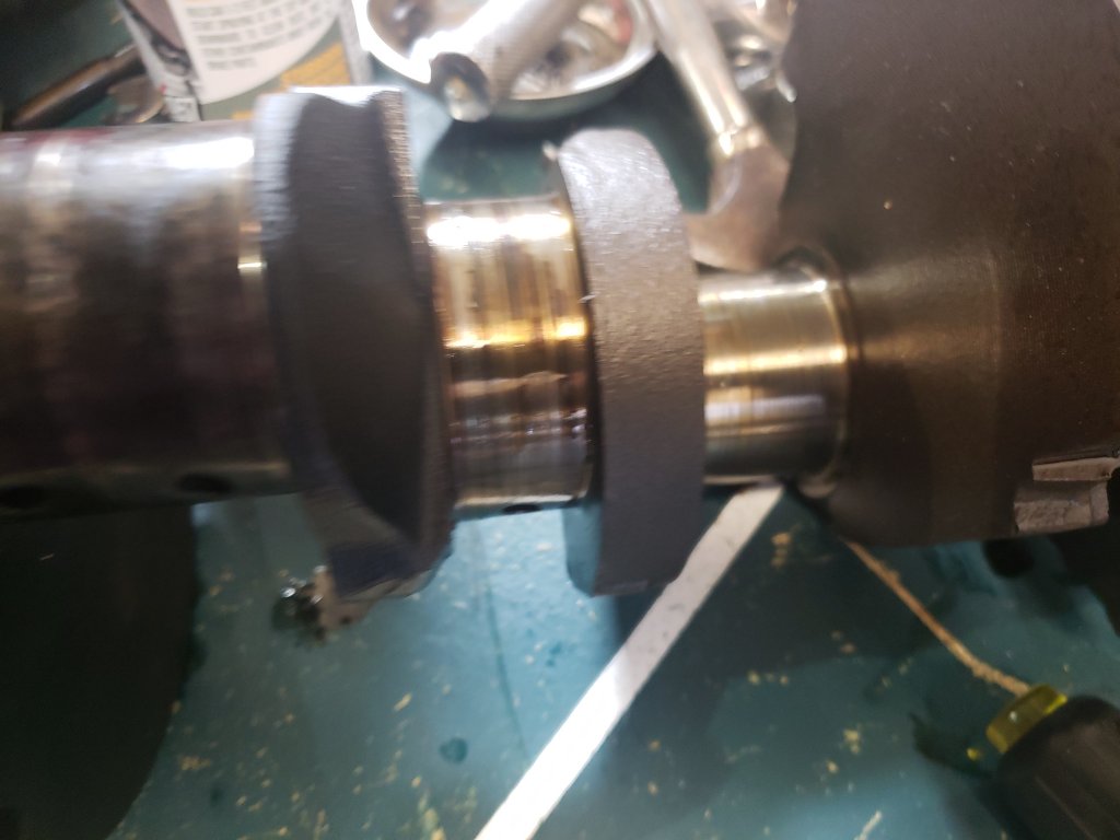

Also, for those that like "dirty pictures," these are the mains and journals from the 350 I pulled.
