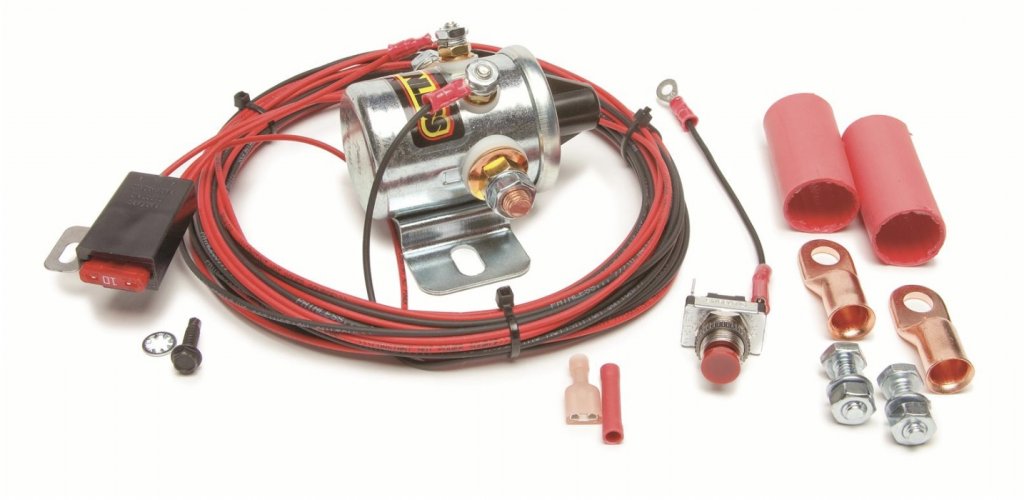

I just installed the Painless Performance Remote Master Disconnect Kit 30206 on my 1978 K20. I removed the battery and battery support, and mounted the solenoid under the battery support. It cannot be accessed without removing the battery and support. I routed the wires back to the driver’s side of the cab using the factory plastic wiring loom cover. Mounted the switch under the dash in a hidden location. In my case I needed to install longer battery cables, but they needed to be replaced anyway. It worked out very nicely.

One disadvantage putting a kill switch in the distributor battery feed is the engine can still be cranked. With no spark, the carburetor will fill the cylinders with fuel mix, then into the exhaust. When you do fire it off you will have flooded condition as well as a muffler fire/explosion.
Most would choose a starter wire kill switch.
If you choose a battery disconnect solenoid, make sure it is a continuous duty solenoid.
