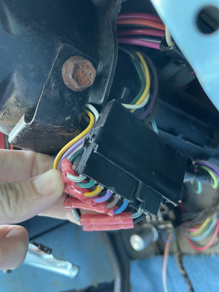

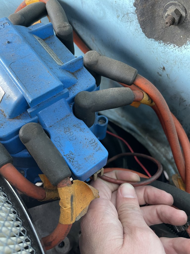

Yes it’s a carbureted 350. I figured it was mechanical since I wasn’t seeing a relay and found where the fuel pump was located. Thanks for clarifying.
Are these the wires/switches you’re referring to?

On the underhood picture yes it would be the one marked batt.
On the steering column I think you have hold of something else. This link shows a good picture of a new ignition switch, though the color of yours maybe different. https://www.ebay.com/itm/393495995429
And that thing mounts to the column.

I believe that switch is located on the column, under the cover. I was trying to avoid taking the whole column out, but I’m not sure I can get to those wires without taking the whole thing off.
I guess a somewhat easy install isn’t so easy?
1,589
2,150
Column can be unbolted from the dash support; it will drop down quite a bit. Switch is on top of the column. If automatic trans be sure to disconnect the pointer cable first.
If for an anti-theft modification interrupting the starter circuit will do the same thing. That switch is near the bottom of the column and is somewhat easier to access. I think the wires are purple. You will need a higher amp switch.

I wouldn’t mess with the column and ignition switch. What I did is cut the wire to the batt terminal on the distributor. The end that goes away from the distributor got moved to terminal 30 on a Bosch style relay mounted on the firewall. The other end that goes towards the distributor goes to terminal 87a on the relay. 85 goes direct to the battery and 86 goes to one side of the switch in the cab. The other side of the switch goes to ground near the switch. Basically this will mean that if the relay or switch fails, the ignition will be failed to “on”. When the switch is activated and a ground is applied, the relay is actuated and disconnects the ignition power to the distributor.

@76_shorty If there is nothing wrong with the ignition switch currently why not just splice the switch into the distributor power wire and save yourself the trouble.
